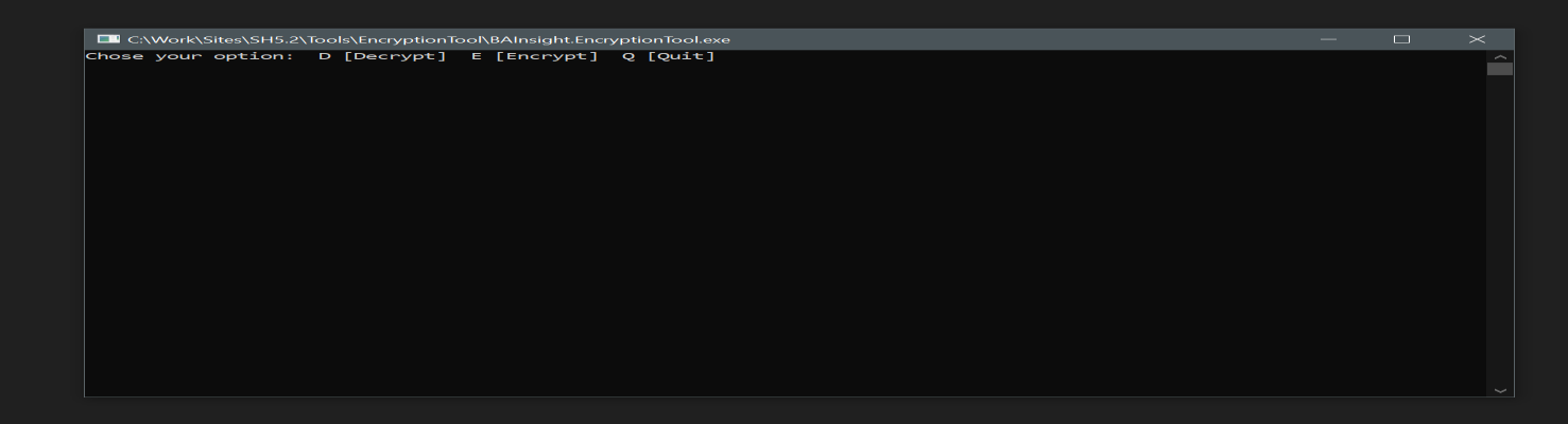

Using the SmartHub Encryption Tool
The SmartHub Encryption Tool can be found in <SmartHubRootFolder>\Tools\EncryptionTool.
Run the tool via the file BAInsight.EncryptionTool.exe.
The regular steps are "Decrypt" and then "Encrypt". See the image above.
  • Decrypt
    • When choosing the decrypt option, the configuration files from the encryptedFilesFolder will be decrypted and saved in the decryptedFilesFilesFolder
  • Encrypt
    • When choosing the encrypt option, the configuration files from decryptedFilesFilesFolder will be encrypted and saved in the encryptedFilesFolder.
If you use the default values for the encryptedFilesFolder and the decryptedFilesFilesFolder, the initial files from the Configuration folder will be overridden with the newly encrypted files
