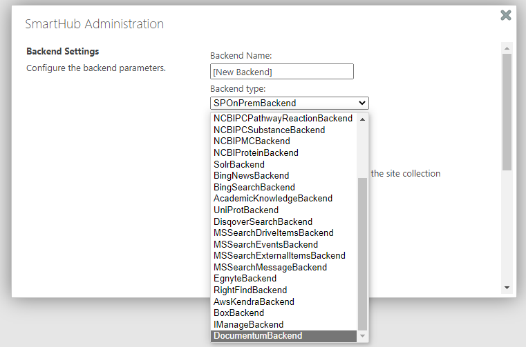

  1. Start by opening your SmartHub Administration site:https://<SmartHubSite>:<port>/_admin.
  2. Add a new backend.
  3. TheBackend Settingspage appears.
    Select DocumentumBackendfrom the "Backend type" drop-down menu:

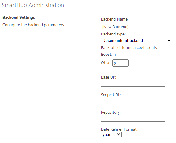

  4. Complete the following fields on the page:
    • Base Url:
    • Scope URL
      • The scope URL configured in Azure application created for Documentum
    • Repository:
      • Name of Documentum repository to search
    • Date Refiner Format:
      • Select what refinement values to display for dates
      • Possible values: "year", "quarter" and "month"
