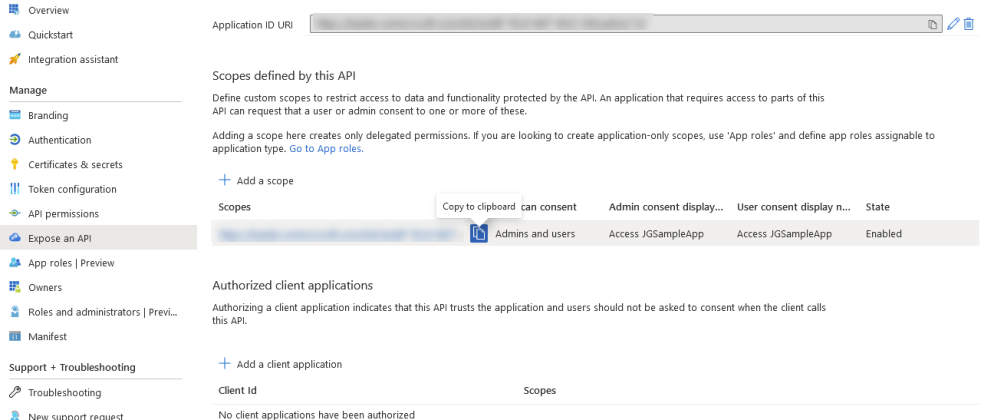

  4. Create the App ID URI.
    1. Click Expose an API section on the left side navigation menu.
      1. To manually set your App ID URI, click Set at the top of the page.
      2. To set your App ID URI automatically, continue to add a scope, below.
    2. Click the Add a Scope button.
    3. In the window that appears, note the Application ID URI is shown below the "Scope name" field (with the field empty).

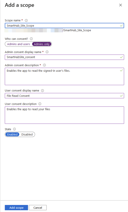

      Configure a scope to be used by SmartHub to provide permissions-based access to its resources.
      1. Scope name: Enter a scope name
      2. Who can consent: See here for more information.
        1. Admins and users - Every user can themselves consent; they will see the message to “SmartHub wants to sign in as you”.
        2. Admins only - Admin consent serves as pre-consent for all users.
      3. Admin consent display name: Enter a consent display name.
      4. Admin consent description: Enter a description for the Admin consent.
      5. User consent display name: Enter a name for the user consent.
      6. User consent description: Enter a description for users consenting to the API.
      7. State: Enable or Disable the scope. This can be changed as needed.
    4. When done, click Add scope.

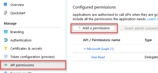

Add Permissions
Add permissions for the application:
  1. Click API permissions>Add a permission.
  2. If not already present add the Microsoft Graph user read permission.
    Click Select an API>Microsoft Graph>Delegated>User.Read.
  3. Add the following permissions by selecting API > SharePoint>Delegated.
    (Select "APIs my organization uses" as a shortcut, if you desire).
    Note: These are delegated permissions. SmartHub access is limited to the sites the user has access to.
    These options do not grant access to all sites in the tenancy, but all sites the user can access.
    1. User.Read.All
      1. Read user profiles
    2. Sites.Search.All (Required only for the SharePoint Online backend)
      1. Run search queries as a user
    3. TermStore.Read.All (Required only for the SharePoint Online backend)
      1. Read managed metadata
    4. Click Add permissions when done.

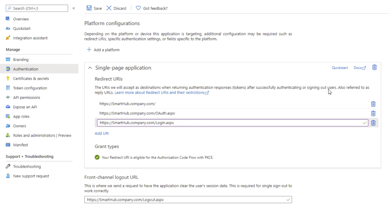

Redirect URIs
Enter app Redirect URIs (previously called Reply URLs).
  1. Click Authentication from the left-side navigation.
  2. Click Add URI under Single-page application in the middle of the screen
  3. Enter <your app Redirect URIs> in the format: https://search.company.com/(OAuth/Login).aspx
    1. These addresses must start with https
    2. These addresses are case-sensitive.
    3. You must enter both Login and OAuth URIs.
  4. Logout URL: Enter the log-out URL in the format: http://search.company.com/Logout.aspx
    NOTE: If you have existing Redirect URIs, recreate them anew instead of migrating them to the single-page application (SPA) platform configuration.
  5. Click Save at the top of the page.

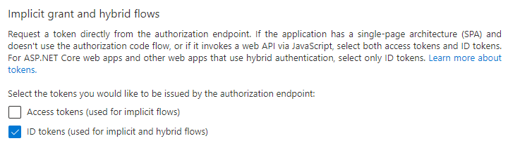

Implicit Grant
If you use a SharePoint Online backend enable Implicit Grant for ID tokens:
  2. Scroll down to Implicit grant and hybrid flows.
  3. Ensure that the ID tokens option is enabled.

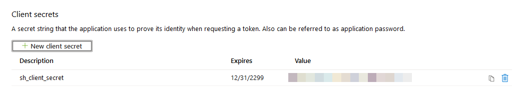

  1. Click Certificates & secrets>New client secret to generate a client secret key for the app.
  2. In the window that appears (shown below) enter the following information.
    1. Description: Enter a name for the client secret. (Note: The name is your client secret).
    2. Expires: Select Never expires.
    3. A Value is generated after you click Add.
    4. Copy the new client secret value. You cannot retrieve the secret value after you perform another operation or leave this page.

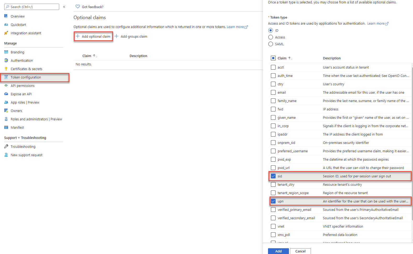

Token Configuration
  1. Select Token configuration from the left-side navigation.
  2. Click Add optional claim.
  3. Select ID as *Token type.
  4. Select upn and sid under Claim.
  5. Click Add.

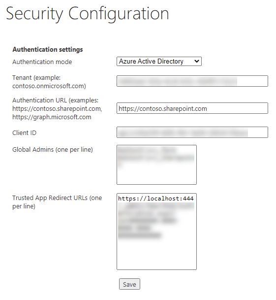

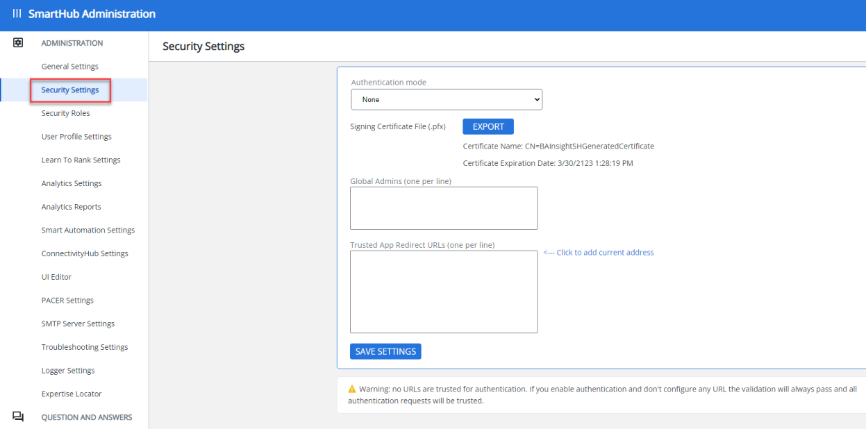

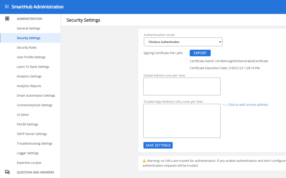

Enter Your Authentication Settings (Azure AD) in SmartHub
  1. Navigate back to the SmartHub Administration page by going to the _ADMIN folder and navigating to the SmartHub admin User interface (UI).
    Alternatively, enter:
       http(s)://[web-app-url]/_admin
  2. Select Security Settings.
  3. Authentication mode: Select Azure Active Directory.
    1. Tenant name or ID (required): Specify your Azure tenancy name in this format:
      1. contoso.onmicrosoft.com
        or
      2. Enter your tenant ID
    2. Client ID (required): The "Application ID" as shown in the Azure Portal App Registration page for your application.
    3. Enter permission scopes for Azure App separated by comma: Paste in the custom scope defined in your Azure App from the "Expose an API" section. See the screenshot below.
    4. Client secret of Azure App: Enter a client secret if you have configured a Sharepoint Online backend.
    5. Admins users (one per line): The local administrator account(s) email address (username@domain.com). Enter one user account email address per line.
    6. Trusted App Redirect URLs: List of application URLs that use SmartHub to validate the user's credentials.
      1. This also includes custom DNS names used for the server hosting SmartHub.
      2. All BA Insight applications integrated with SmartHub are listed here.
      3. For example, see the following application URLs (some optional):
        1. SmartHub site URL: The SmartHub site address, as accessed by users.
          Note: You must list any registered DNS names that access your SmartHub server. Otherwise, users will not be able to authenticate with SmartHub.
        2. Smart Previews site URL: Optional. The Smart Previews site address, as accessed by users.
        3. ConnectivityHub site URL: Optional. The ConnectivityHub site address, as accessed by users.
        4. Custom apps: Optional. The URLs of custom applications that are integrated with SmartHub.
  4. Click Save to return to General Settings to see the "Security settings: Secured" message.

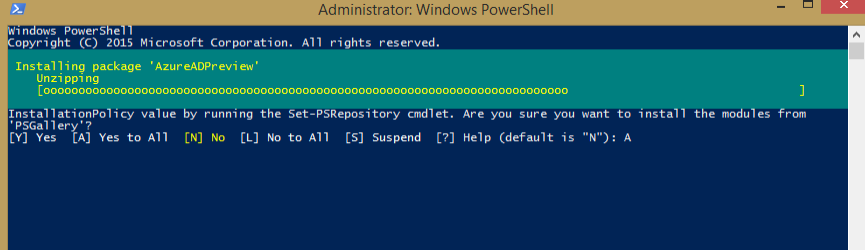

  1. Open a Windows PowerShell with Administrative privileges.
  2. Install the AzureAdPreviewModule with the command Install-Module -Name AzureADPreviewas shown below:
  3. Enter "[A] Yes to All".
  4. The package installs.

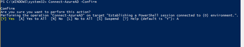

  5. Connect to Azure AD with the command Connect-AzureAD -Confirm as shown here:

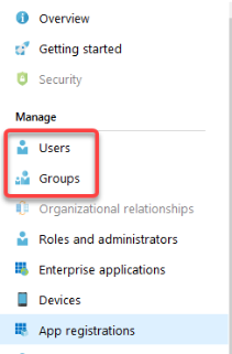

Optional: Restrict Access to SmartHub from Azure
Active Directory Authentication
If the option for user assignations is enabled (see here for more info), then everyone under the "Users" and "Groups" list in the App registration in Portal (portal.azure.com) has access.
  • Azure Active Directory enables you to restrict your SmartHub site (app) to a set of users by following these instructions: https://docs.microsoft.com/en-us/azure/active-directory/develop/howto-restrict-your-app-to-a-set-of-users.
  • The result is that any user not assigned to the app cannot access it.
  • Users, by name, are not strictly denied.
  • Any user not specifically assigned access is denied.
  • Login attempts that fail result in the user being prompted to re-login.
    Note: If a user attempts to login with an account that cannot access SmartHub, but then switches to one that can, the user must refresh their SmartHub page otherwise O365 may become stuck on the “logging you in” page.

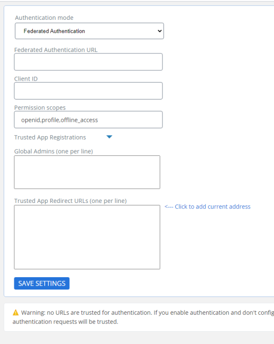

Use the following information to configure Federated-type user authentication in SmartHub.
About Federated Authentication
SmartHub supports Federated-type authentication, which is any authentication service that is OAuth 2.0 compliant.
Supported identity providers include:
  • Microsoft ADFS
  • Okta
  • Auth0

Configure SmartHub Federated Authentication
  1. Navigate to the SmartHub Administration page by going to the _ADMIN folder and navigating to the SmartHub admin user interface (UI).
  2. Security Settings: Click "Security Settings" and the Authentication settings page appears.
  3. Authentication mode: Select Federated Authentication from the drop-down menu.
  4. Tenant Name (optional). Enter the name of the tenant for your Federated Authentication service.
  5. Federated Authentication URL (required): Specify your Federated Authentication service URL.
  6. Client ID (required): Specify your app ID.
  7. Signing Certificate File (.pfx):
    1. Click "Browse..." to upload a valid certificate (.cer ), without the private key.
      1. The certificate (.cer) must be exported from your authentication provider.
      2. The certificate is used to validate the tokens that your authentication provider generates.
        Note: Make sure your certificate has not expired.
        For more information about certificates, see: What Are Certificates?
  8. Admin Users: Enter the list of users who will enjoy administrative rights to your SmartHub site.
    1. User credentials must be entered in the format Domain\username or Username@domain.
    2. 'Anonymous' may be entered, but it is not recommended for security reasons.
    3. Groups are not supported.
  9. Make sure your Federated Service includes the UPN property in its claims for the user.
  10. Click Save and return to General Settings to see the "Secured" message:
Example Identity Provider: Okta
The following example describes how to configure Okta as your identity provider.
Note: You must have access to your Okta application settings on the Okta website.
Tenant Name is not required.
  • Authentication mode:
    • Select Federated Authentication
  • Federated Authentication URL
    • URL of your Okta Authorization Server: the server configured with the UPN claim in the ID token for the open ID (or All) scope
    • For example: https://<tenant>.okta.com/oauth2/default
    • See the example screenshot below
  • Client ID
    • The active application Client ID. Taken from the Applications page of the Okta web site. See below.
  • Signing Certificate File
  • Global Admins (one per line)
    • List of users to enjoy administrative rights to your SmartHub site. See Step 8, above.
  • Trusted App Redirect URLs
    • Click the link to the right of the field to add the current address.
  • Click Save when complete.

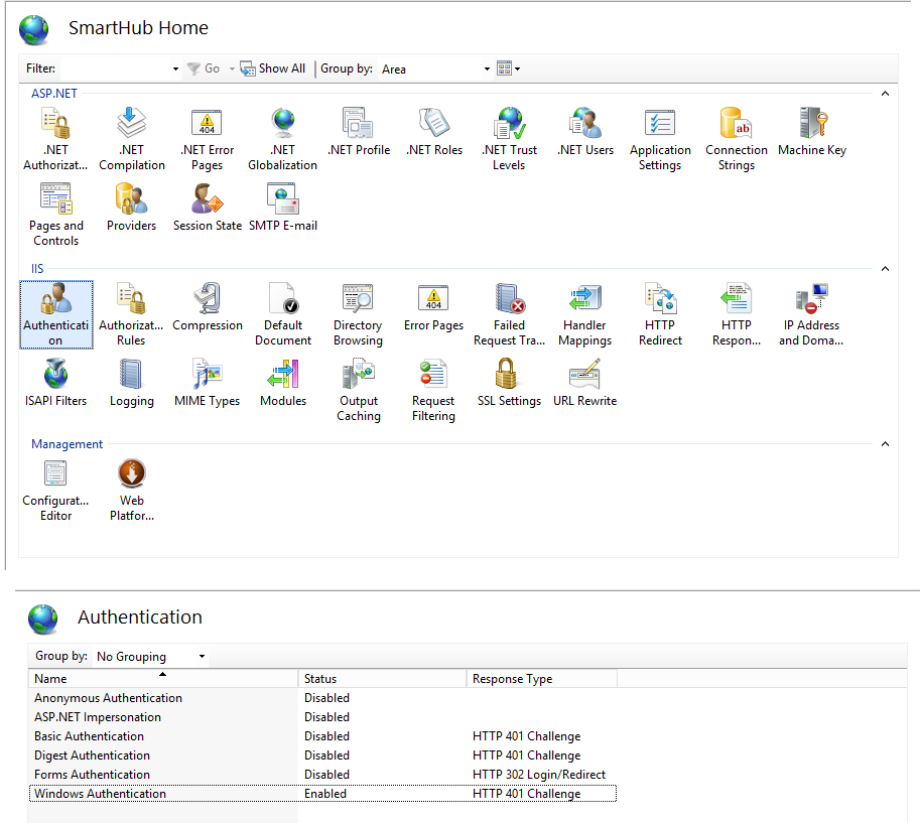

Set Your SmartHub Site to Use Windows Authentication

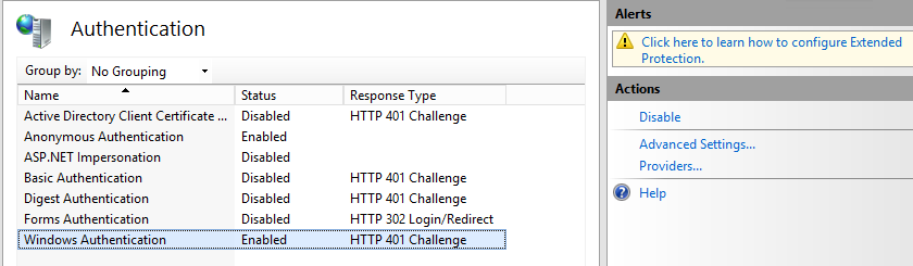

  1. Edit your SmartHub site in IIS Manager.
  2. Select IIS>Authentication.
  3. The Authentication window appears:
  4. Anonymous Authentication: MUST be set to Disabled.
  5. Windows Authentication: MUST be set to Enabled.

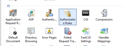

    1. Everyone that is configured in IIS under “Authorization rules” has access.
    2. Authorization rules are located next to "Authentication" from the IIS SmartHub site screen.
  6. Go to IIS Manager → Go to the application pool instance → Click advanced settings.
    Under Process model, set Load User Profile to True.

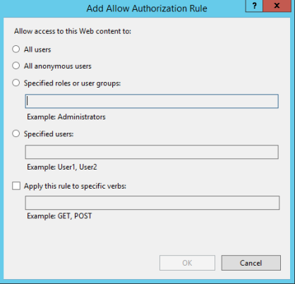

Optional: How to Authorize or Restrict User Access to SmartHub
Once Windows has been set as your authentication mode in SmartHub, and set to Enabled in your SmartHub IIS site, set the rules for authorizing users using the steps below:

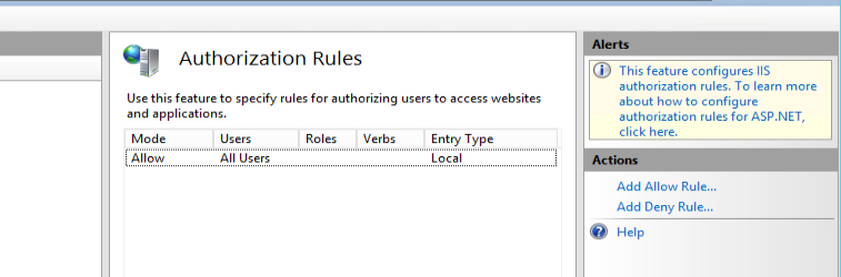

  2. Select IIS>Authorization rules.
  3. Add an "Allow" or "Deny" rule using the links under the Actions section in the right-side pane.
  4. Set user access as desired, and click OK.
