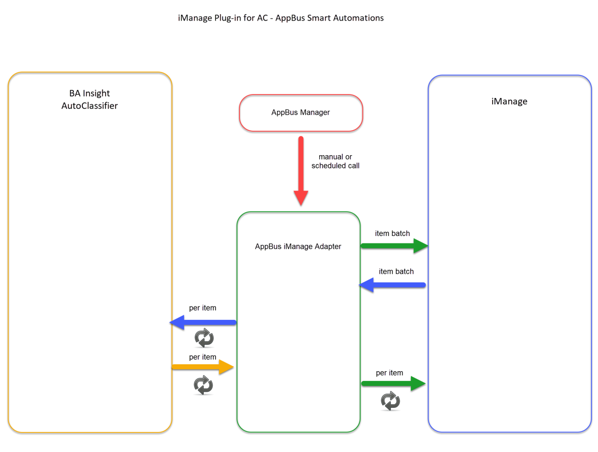

The iManage AppBus Plug-in for AutoClassifier integrates the AutoClassifier processing pipeline capabilities with the iManage source system.
Metadata created via an AutoClassifier processing pipeline is pushed directly into iManage documents' properties.

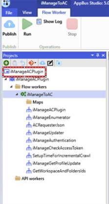

  3. Select the iManageACPlugin project folder and open the asln file.

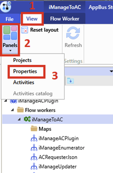

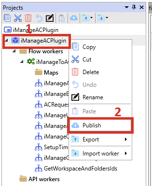

  4. From the left side, from Projects, select iManageACPlugin.See below.
  5. From the above menu, select View → Panels → Properties.

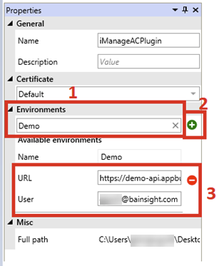

  6. On the right side, a properties dialogue box appears.
  7. Enter a name in the Environments field, and press the '+' button.
  8. Enter
    1. URL:
      1. Enter the URL of your AppBus Server API Endpoint. To find this:
        1. Login to the AppBus Server UI.
        2. Go to the "Management API" in the left navigation.
        3. Find the "Computed URL".
        4. Use this value. For example: https://appbus-api.test.local/v1
    2. User:
      1. Enter the AppBus Cloud Tenant access user in the format name@domain.com.
      2. See the example above.
      3. Acquire this information from BA Insight Support team.
  9. From the left side, right-click on iManageACPlugin and select Publish from the sub-menu that appears.

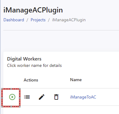

  11. Click Execute.

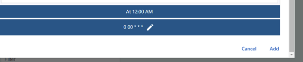

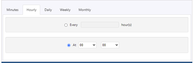

Schedule
This option can be used in order to schedule an incremental crawl.
  1. Select /api/101/153/iManageACPlugin
  2. Select Schedule.
  3. Complete all the requested parameters and set the isIncrementalCrawl parameter to true
  4. Complete the parameters and the scheduled time when the plug-in is to run.
  5. Click Add.

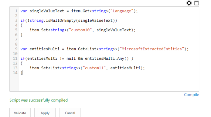

To re-name AutoClassifier output properties to match the iManage search schema, use the scripting stage with scripts as in the examples below.
  • The scripting stage must be the last stage in your processing pipeline.
Example 1: For single-value text properties
Copy
var singleValueText = item.Get<string>("Language");
if(!string.IsNullOrEmpty(singleValueText))
     item.Set<string>("custom10", singleValueText);
Example 2: For multi-valued text properties
Copy
var entitiesMulti = item.Get<List<string>>("MicrosoftExtractedEntities");
if(entitiesMulti != null && entitiesMulti.Any() )
     item.Set<List<string>>("custom11", entitiesMulti);

See the screenshot below:
