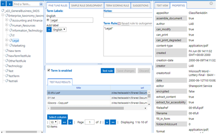

  1. Go to the Manage Taxonomies page and select a taxonomy. The Taxonomy Editor, or Test Bench, interface is displayed.
  2. In the middle panel, click Select columns and the Select Columns pane appears.
  3. Options such as title and url: Select one or more of these columns.
  4. Click Done.
  5. Click on a rule/taxonomy node.
  6. OIn the middle panel, click Test rule.
  7. In the Test rule results pane, scroll through the document list and click on a document.
  8. In the right panel, click the TEXT VIEW tab to see the matched terms:
    • Original Score:
    • Final Score:
    • Click the Properties to see the metadata for the tested document:
      See the Properties pane.
