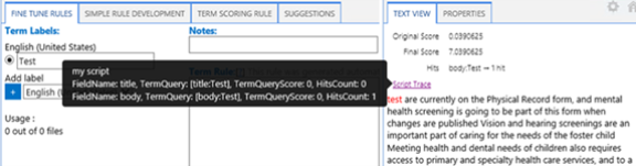

  4. Click a taxonomy node such as "Accounting" and "Finance."
  5. Click the TERM SCORING RULE tab.
  6. Select Use scoring rule defined higher in the term hierarchy. If a scoring rule is defined higher up in the taxonomy, this text box is automatically filled in with the inherited rule (the closest rule that is defined in the parent hierarchy).
  7. Click Specify scoring rule to use and select a scoring rule that you defined in your scoring rules such as Rule 1.
  8. Click Save changes.
  9. Original Score: This score is returned by Lucene.
  10. Final Score: This score is calculated by the scoring rule.
  11. Click Script Trace to see that your script executed, rule matches, hit counts, and so on. (All WriteTrace method calls from your scoring rule script.)
