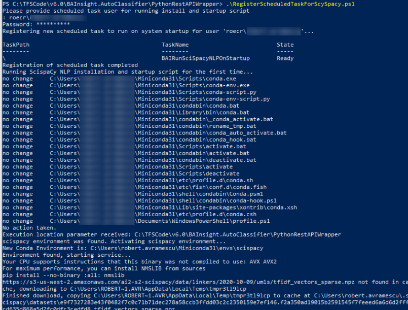

How Install and Activate SciSpacy
Locate the PythonRestAPIWrapper folder in the BA Insight <AutoClassifier_engine_install_root>\Admin Site directory.
The files inside this folder are used during the following installation process.
  1. Open Windows PowerShell as an Administrator
  2. Navigate to the PythonRestAPIWrapper folder (run command: cd " your path to PythonRestAPIWrapper")
  3. Next, run the following command:
  4. Copy
    powershell -ExecutionPolicy ByPass -File RegisterScheduledTaskForSciSpacy.ps1
  5. When prompted, specify the user and password for a local administrator and press Enter.
    1. This user is used to run Spacy NLP install commands and must have permissions to create scheduled tasks and run PowerShell scripts on your system.
  6. When prompted to proceed, enter 'y'for Yes.
Installation Verification and Continuous Operation
The installation process is complete when you see a message, similar to the following, displayed in a new powershell console:
"Serving on http://yourcomputername.domain:8080"
See the screenshot below.
Check that Scheduled Task to automatically start the REST API wrapper was successfully created:
  1. Open Windows Task Scheduler
  2. Check for the task:
      BAIRunSciSpacyNLPOnStartup
Note: This task automatically starts the REST API server at system startup.

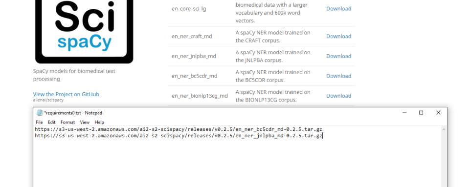

Configure the SciSpacy NER Models
To configure (add/remove) the SciSpacy NER models used by your SciSpacy Instance:
  1. Navigate to SciSpacy models page and review the models available.
  2. Decide on the new models you want to add.
  3. Download all new models.
  4. Create a new SciSpacyRequirements.txt.
    • Example: SciSpacyRequirements0.txt
  5. Add the download links of the models you want to use on separate lines as in the example below:
  6. If the SciSpacy Python wrapper is running, close the Anaconda Console to stop the service.
  7. Open the Anaconda Console as an Administrator and run the following commands:
    Copy
    conda activate scispacy
    pip install -r requirements0.txt --no-cache-dir --user

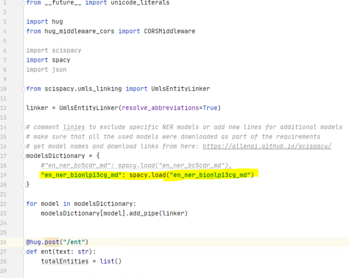

  8. After the requirements are downloaded successfully:
    1. Navigate to the PythonRestAPIWrapper folder
    2. Edit the file "SciSpacyWrapper.py" as in the example below, depending on which models you want to use:
  9. Add or remove lines similar with line 19 in the example above containing the name of the model you want to use (and downloaded via the SciSpacyRequirements.txt file).
  10. To start the SciSpacy Python instance using the new model configuration run command in the Anaconda console you have opened:
       python.exe SciSpacyWrapper.py
  11. The process is complete when you see a message displayed such as:

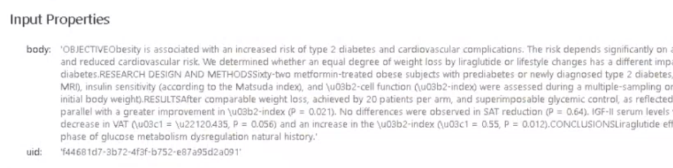

Input Properties
  • The metadata property specified in the stage configuration in the Input Property field.
Input Property Example
