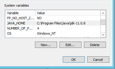

Java Requirements
Java
  • BA Insight supports Java v11. See https://adoptium.net/temurin/releases/?version=11.
    • Java v11: Must be set as a system variable, and NOT a user variable!
  • BA Insight develops and tests using Adoptium.
  • BA Insight does not guarantee support of Oracle Java, but it may function in your environment.

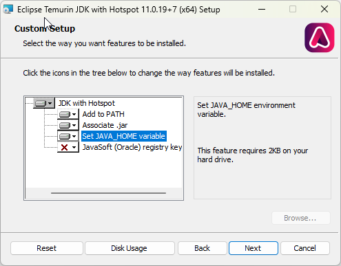

Adoptium JDK (v11)
Select the Custom Setup options shown below:
