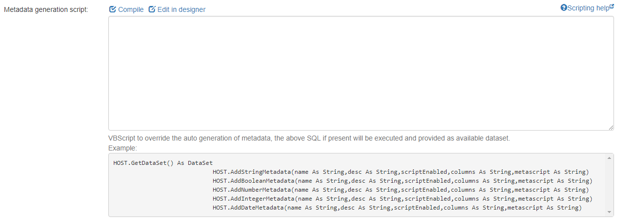

Access and Use the Metadata Generation Scripts
The Metadata Generation Script is used to override automatic metadata generation for the selected content source.
This script is available only for the SQL Connector.
  1. On the Connectivity Hub page, click the content source name under Content.
    1. Click the Advancedtab.
  2. Scroll down to see Metadata Generation Script.
  3. Use the following HOST functions to generate the list of metadata properties that you require.
SQL Connector: Metadata Generation Parameters
Sub-type Function (HOST object) Input Parameters (Type) Return Type Description
Data Access GetDataSet()
DataSet Provides direct access to the items data set.
Specific to the Unstructured Field
AddStringMetadata()
ByVal name (String)
Adds the string metadata to the columns.
AddBooleanMetadata()
ByVal desc (String)
Adds the metadata as a Boolean value to the columns.
AddNumberMetadata()
ByVal scriptEnabled (Boolean)
Adds the metadata as a number value to the columns.
AddIntegerMetadata()
ByVal columns (String)
Adds the metadata as an integer value to the columns.
AddDateMetadata() ByVal metascript (String) Adds the metadata as a date value to the columns.

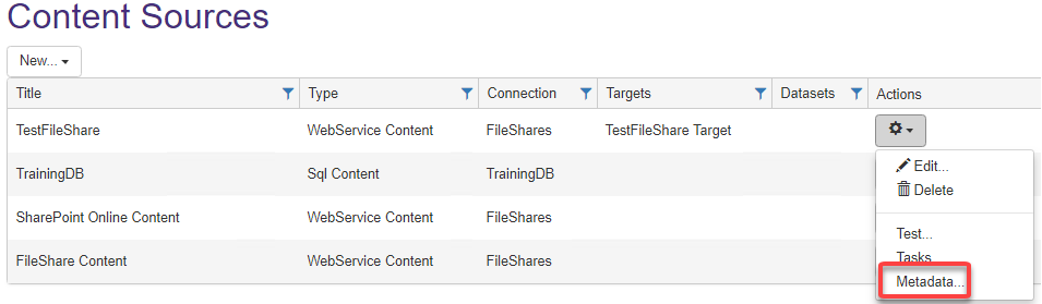

Add/Edit metadata to control values for the search index
When you specify the your custom metadata fields, you can write a VB.NET script to control the value that goes into the search index.
  1. Content Sources: Click the Content Sources link to see the Content Management page.

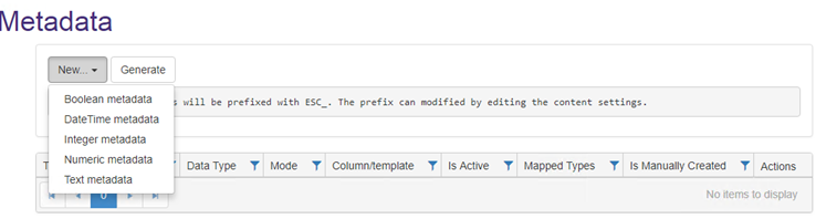

  2. Actions: Click Metadata for the content that you want to modify.
  3. The Content Metadata page appears.
  4. New: Click "New" to select the type of metadata that you will use.

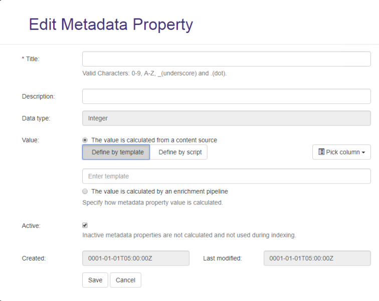

  5. The Edit Metadata Property dialog appears.

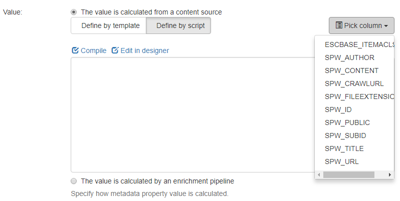

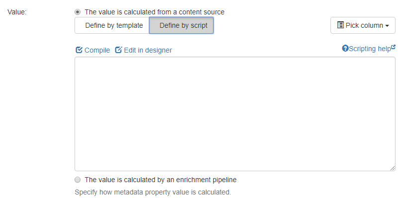

  6. Click Define by script in the Value field to access the scripting pane.
  7. Pick column: Select a property in the drop-down.
  8. Click the Compile link above the field to validate the script.
  9. Click Save to save your settings and return to the Metadata page.
    1. The global variableHOSTis accessible for any of your scripts
  10. You can choose to return a string for a single value or a string array for multiple values.

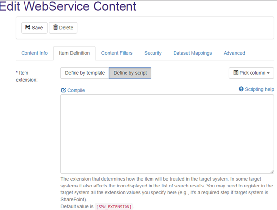

Index Item Scripts and Functions
After you add and test content such as SQL Server Content, and WebService Content, you can write scripts to determine how items are indexed.
  1. Go to Contentclick on a content type under Content.
    The <type of> Content page appears.
  2. Click the Item Definition tab and scroll down to see the required Item Extension box.
  3. Reference DS Columns with brackets (required): Make a selection such as SPW_EXTENSION.
  4. Advanced (required): Click the Advanced tab.
  5. Enter your script using the information provided above in this section.
  6. Compile: Click the Compile link above the field to validate and use your script.
