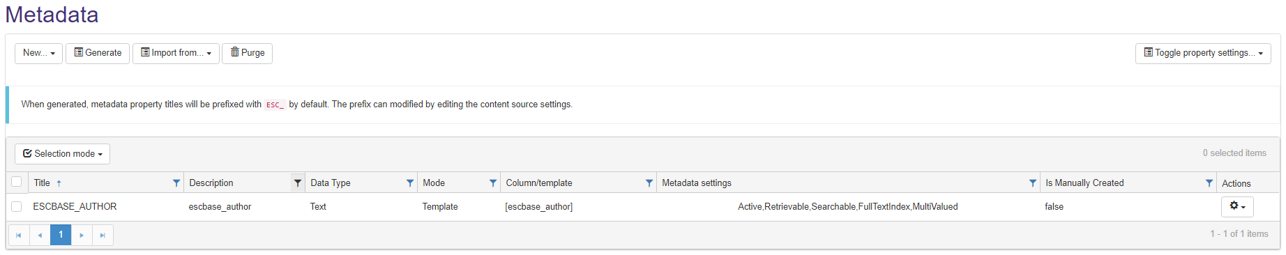

  1. Content Sources: Metadata is accessible at the following location:
    1. Select <your content source>See the configuration gear. > Edit > Metadata.
    2. Click the Generate button to see your metadata.

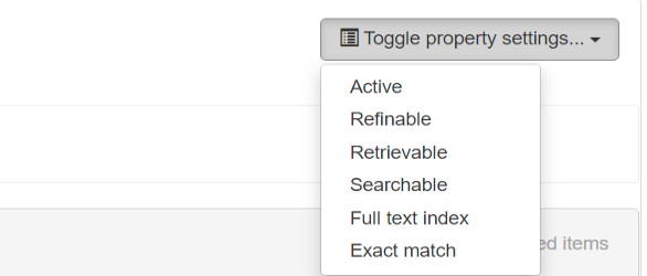

  3. Batch edit metadata settings with the Toggle property settings option:
