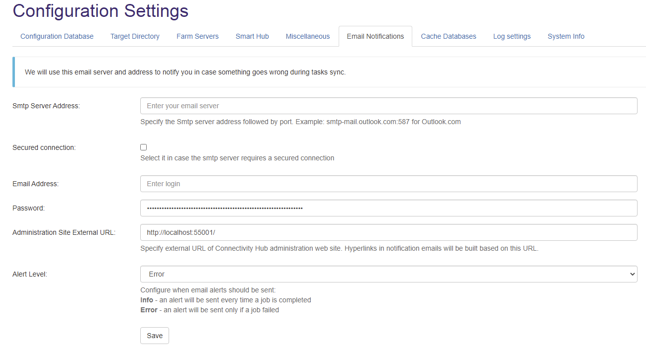

Complete the following fields:
  • Smtp Server Address
    • Enter the SMTP server address, including port
    • Example:
      • smtp-mail.outlook.com:587
  • Secured connection
    • Select if the SMTP server requires a secure connection
  • Email Address
    • Enter the email address of the person to send the email with statistics and information
  • Password
    • User's password
  • Administration Site External URL
    • Enter the external URL of the Connectivity Hub administration website
    • Hyperlinks contained in notification emails are based on this URL
  • Alert Level
    • Controls when email alerts are sent to the specified email address.
    • Available levels
      • Info
        • An email containing a crawl summary is sent at the end of the crawl job
      • Error
        • An email is sent only if the running job crashes.

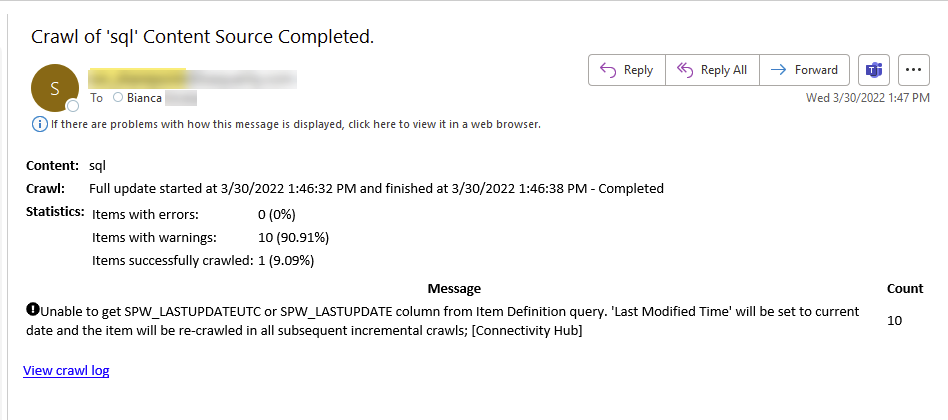

The following example provides a sample email that is sent after a crawl of the "sql" content source is complete.
The email contains important details as well as a link to view the crawl log for an even more detailed look at the crawl log.
  • Read all the information in this email.
  • Confirm the crawl start and stop times to ensure you are viewing the correct email and report
  • Note if the crawl completed
  • Note the crawl statistics
  • For any errors or warnings, consider your content source and any peculiar details about it when troubleshooting or speaking with the Support dept.

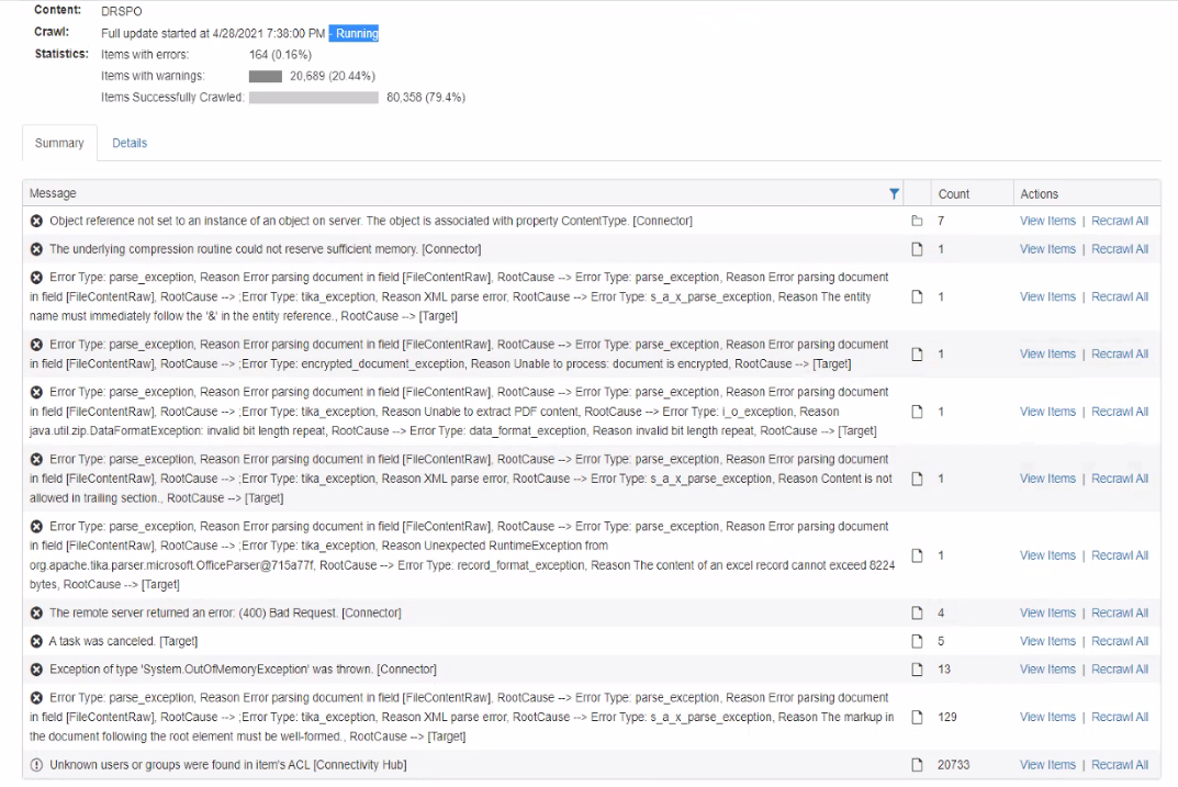

  • Clicking the View crawl log link at the bottom of the screen, results in being taken to the following page with detailed messages about each issue that occurred during the crawl:
