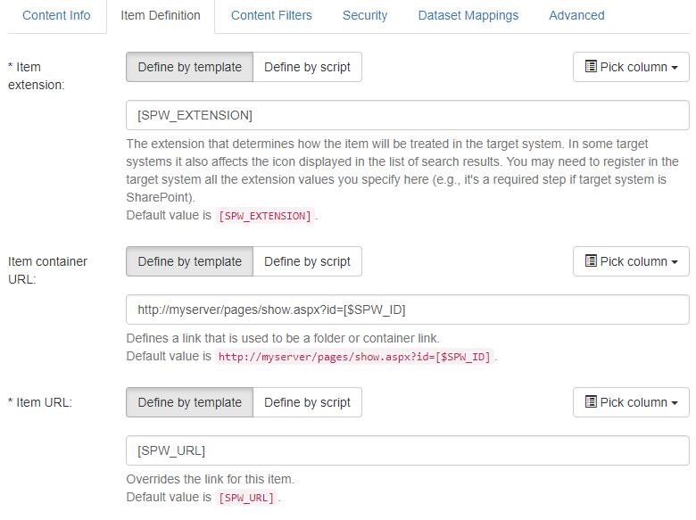

  1. Navigate to the Content Sources page and click <your Web Service Connector> See the gear icon. > Edit.
  2. Click the Item Definition tab. Fill in the following fields:
  3. Item extension:
    1. Define by template: These settings are the default settings and are shown below.
    2. Define byscript: Enter a script using Scripts page.
    3. Pick column: Click to select a database column.
      See the following example of possible selections (this varies according to your selection):
      See the Pick column drop-down list.
    4. Extension field: (required if the target system is SharePoint): By default, [SPW_EXTENSION] is entered.
      1. This is the file extension that is pulled from the content repository (the brackets [] indicate the repository location).
      2. This extension determines how the item is treated in the target system.
      3. In some target systems this specification also affects the icon that is displayed in the list of search results.
      4. You might need to register all the extension values in the target system that you specify here.
  4. Item container URL: Defines a link that is used as a folder or container link.
    The default value is [SPW_CONTAINER].
  5. Item URL: Override the link for this item.
    The default value is [SPW_URL].

  6. Unstructured Data Options: Specifies how the unstructured data is extracted.
    Default value for web service connectors: File (Network Share) with [SPW_FILEPATH]
  7. Item title: Defines the title that appears in the search results. For this reason, the default value is [SPW_TITLE].
  8. Item author: Define the item author. By default,  [SPW_AUTHOR] is entered.

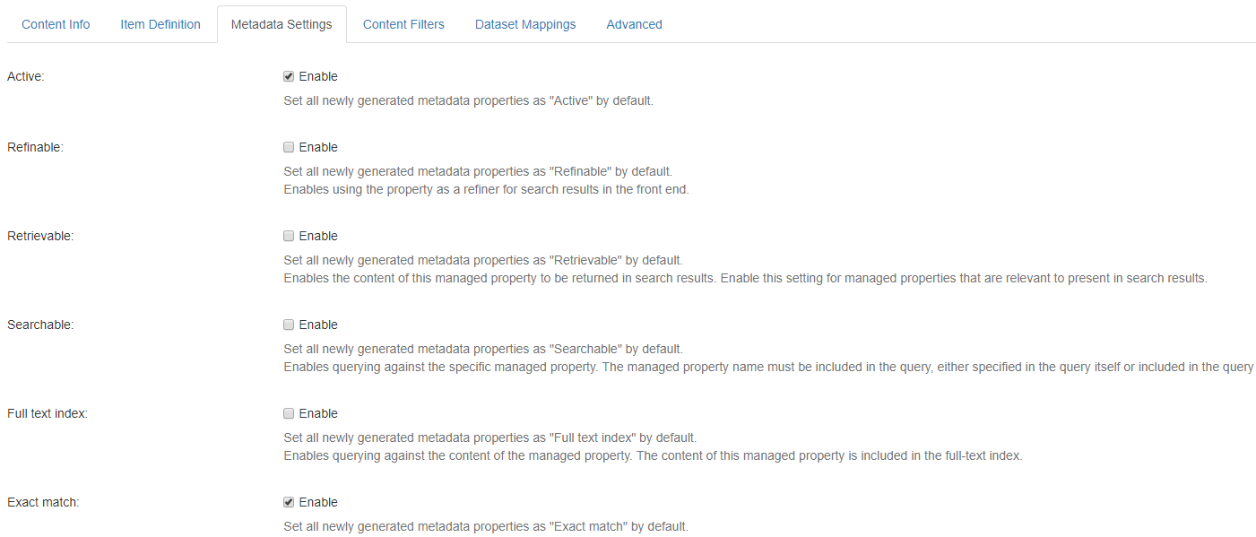

  9. Use the Metadata settings tab to define the default settings for the metadata that will be generated:
  10. Click Save if you make any changes.
