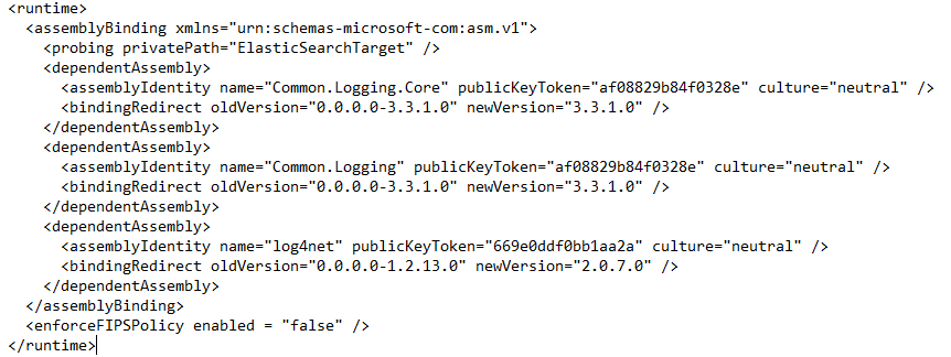

  6. Open the Quartz.Server.exe.config file and locate the run time section.
    Before the run time section closes add the following line:
    <enforceFIPSPolicy enabled = "false" />
    Example:
