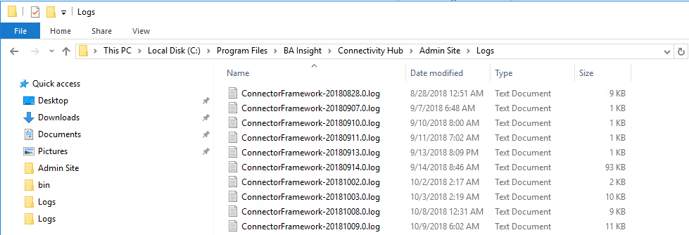

To see or edit the Logging.config for the admin site, navigate to the Connectivity_Hub_root  -> Admin Site - >Logging.config
To see the log entries, navigate to the folder where ConnectivityHub is installed > Admin Site > Logs
In general, you should view the log files located here to discover why:
  • You cannot save a specific content or connection
  • You cannot an exception when performing an UI operation, like opening a target, dataset etc
  • You cannot connect to cache/configuration database
  • Content test bench shows an exception/error/warning

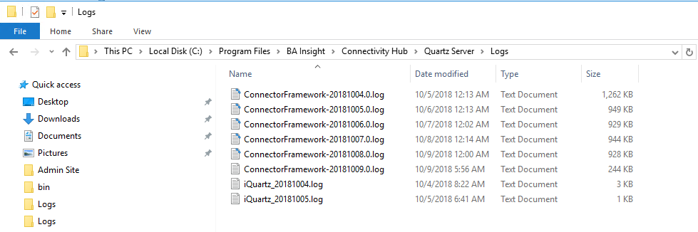

BA Insight provides a predefined configuration file for the scheduler serviceLogging.config, which you can edit in Notepad to specify operations such as:
  • Specify parameters, like log level, buffer size and log file location
  1. These operations are automatically applied when the logs are written.
  2. To see or edit the Logging.config for scheduler service, navigate to the folder where ConnectivityHub is installed > Quartz Server >Logging.config.
  3. To see the log entries, navigate to the folder where ConnectivityHub is installed  > Quartz Server > Logs.

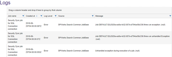

  4. Depending on the logging level selected while starting or scheduling a job, all or a part of the log entries can be seen from Admin Site > Tools > Logs
    See the Logs page.

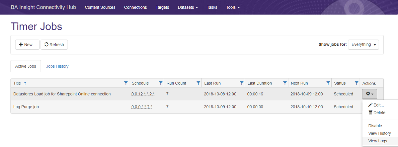

  5. The information logged by each task in particular can also be seen from Tasks > Actions > View Logs
  6. You should check the Timer Job Logs for:
  • Unexpected behavior when you run the target sync.
  • Items missing from incremental crawl.
  • Unexpected behavior when you run Security Sync or any other connection task.
