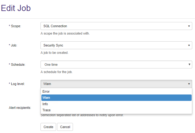

Specify the Logging Level for a Job
  1. From the Connections page, select <your connection> > Tasks >  See the configuration gear. > Tasks.
    See the "Time Jobs" pop-up.
    Select your logging level.
  2. Log level: Use the drop-down to select.

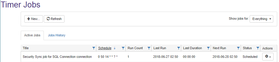

  3. Active Jobs: See the jobs.
    See the Timer Jobs.

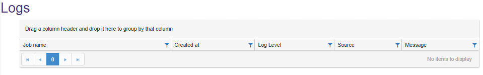

  4. For a given job, click See the configuration gear. > View Logs: for more information.
    See the Logs page.
