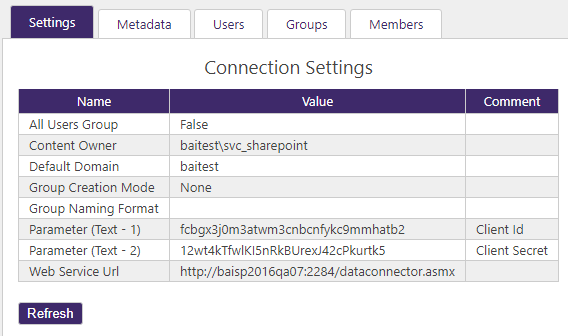

  1. Click on a connection such as the Box Connection > Settings:
    1. Click to see the settings that you specified in the Edit Web Service Connection page > Security tabs.

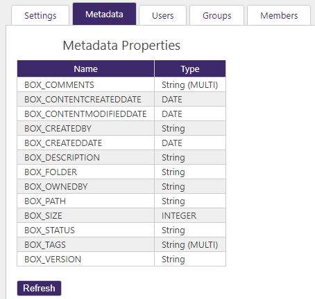

  2. Metadata: Click to see the Metadata page and see any metadata associated with the selected connection:

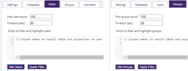

  3. Users/Groups: Click to see the Users/Groups page and see any user/group data that is associated with the selected connection.
    1. Max user/group count: Leave the default, 100, or change.
    2. Timeout (sec): Leave the default, 30, or change.
    3. Script to filter and highlight users/groups: Go to Scripts > Example scripts > User Scripts/Group Scripts.
    4. Get Users/Groups: Click this button to retrieve the specified users.
    5. Apply Filter: Click Apply Filter if you specify a script to filter and highlight users/groups.

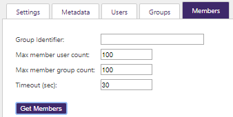

  4. Members: Click to see the Members page and any members data that is associated with the selected connection.
    See the Members page.
    1. Group identifier: This ID appears when you enter a Discovery group account in the Edit Web Service Connection > Security page.
    2. Max member user/group count: Specify the maximum number of users/groups that can be members of this group.
    3. Timeout (sec): Leave the default, 30, or change.
    4. Get Members: Click to see your members list.

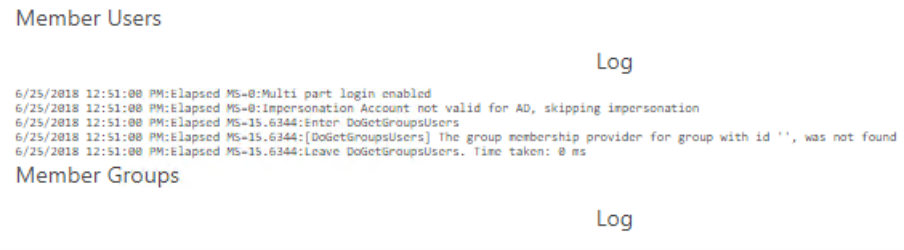

If an error occurs, see the logging information:
See the Member logs.

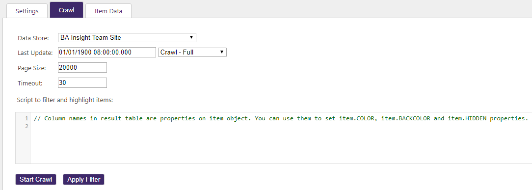

  2. Crawl: Click to see the Crawl page.
    1. Data Store: Select
    2. Last Update: See the date of the last update and the type of operation that ran:
      • Crawl - Full
      • Crawl - Incremental
      • GetChanges
    3. Page Size: Leave the default, 20000, or change.
    4. Timeout: Leave the default, 30, or change.
    5. Script to filter and highlight items.
    6. Start Crawl: Click to retrieve the content from the specified data store.
    7. Apply Filter: Click Apply Filter if you specify a script to filter and highlight items.
