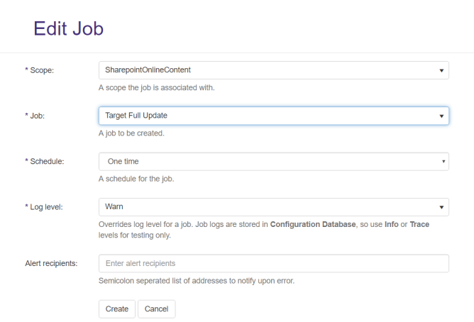

  2. Click New and the Edit Job page appears.

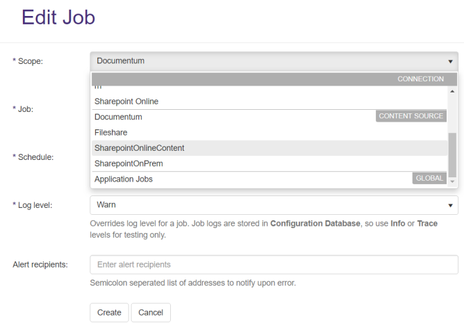

  3. In the Scope drop-down list, select the Content Source for which you want to run a Full Target Update.

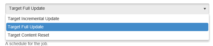

  4. Select "Target Full Update" in the Job drop-down list. Other options are listed below:
    • Target Incremental Update: Select to update only the indexed items that have changed since previous target sync.
    • Target Content Reset: Select to remove the indexed data while leaving the content source that is attached to the data unchanged.
  5. Schedule (Required): Select using the drop down:
    • One Time: Runs the task now.
    • Scheduled: Specify a simplified/advanced schedule for your target job.
  6. Log level
    • Required
    • Default: Warn
    • Alternatively, use the drop-down to select:
      • Error
      • Info
      • Trace
    Any change that you make overrides the log level for a job.
    The job logs are stored in the configuration database, so use Info or Trace levels for testing purposes only.

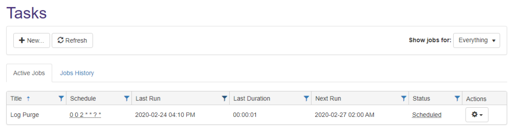

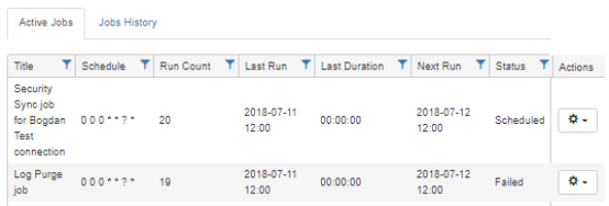

  8. Create: Click "Create" to start your job and see the results in Active Jobs:
    See your target job results in the Active Jobs.

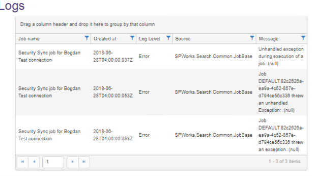

  9. (To resolve issues) See the gear icon. > Edit > View Logs: See the logs for the target job(s) that you ran.
See the Logs page.
