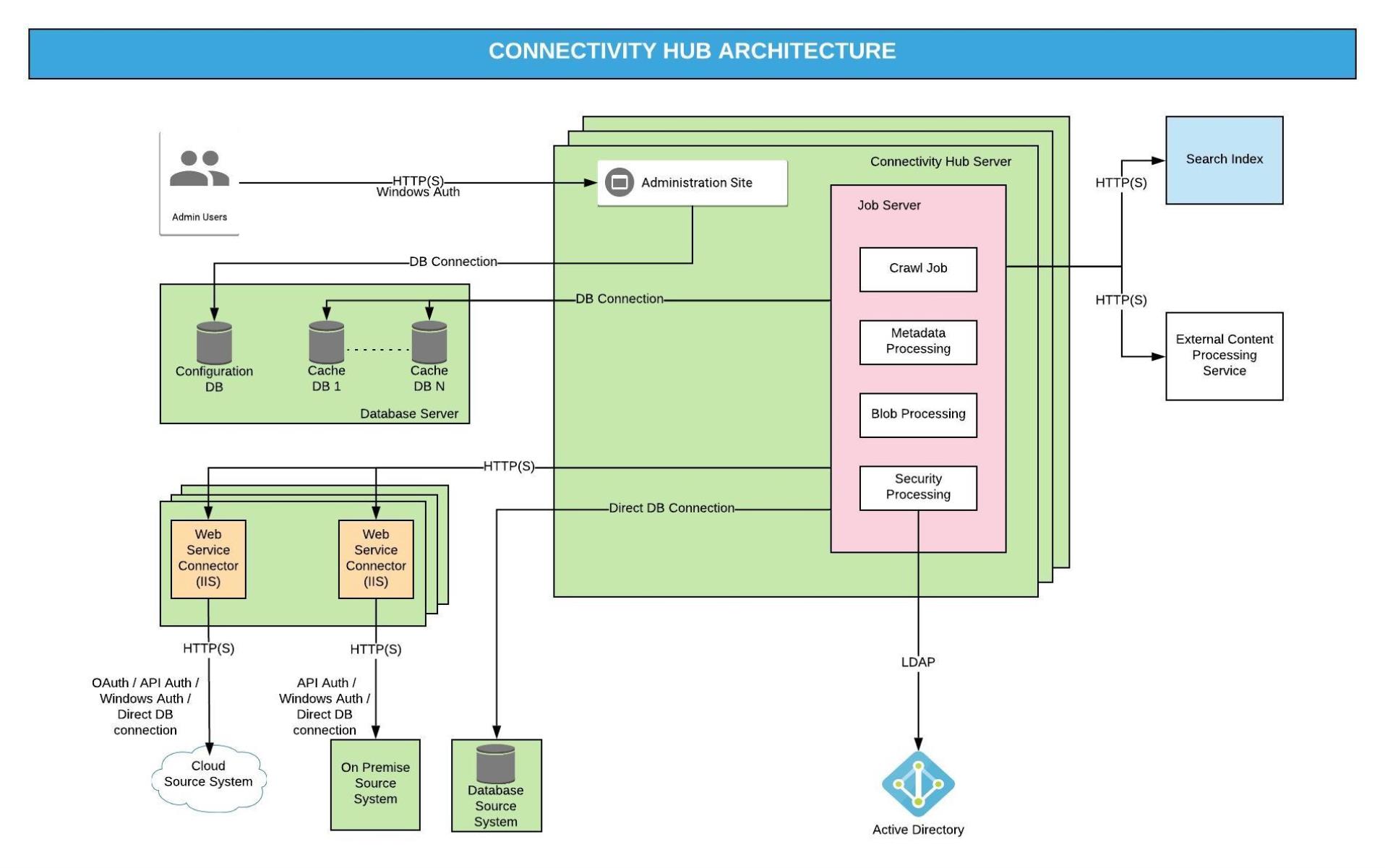

High-Level Architecture
The following high-level diagram depicts Connectivity Hub components, including:
  • Component location
  • Databases
  • Sites
  • Search Index
  • Web Service connectors
  • Servers
  • Potential source systems
  • Protocols used.
