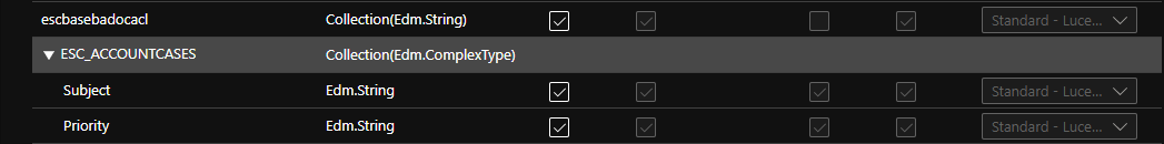

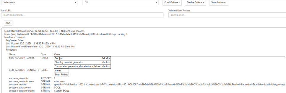

Complex Fields
Table data types from Connectivity Hub will be treated as Collection of Complex fields in Azure Cognitive Search schema.
Azure target cannot create these complex fields, so they require manual input:
You need to add the table field and all its sub-fields in you Azure index and then repeat the full crawl.
