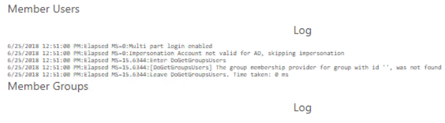

If an error occurs, see the logging information:
