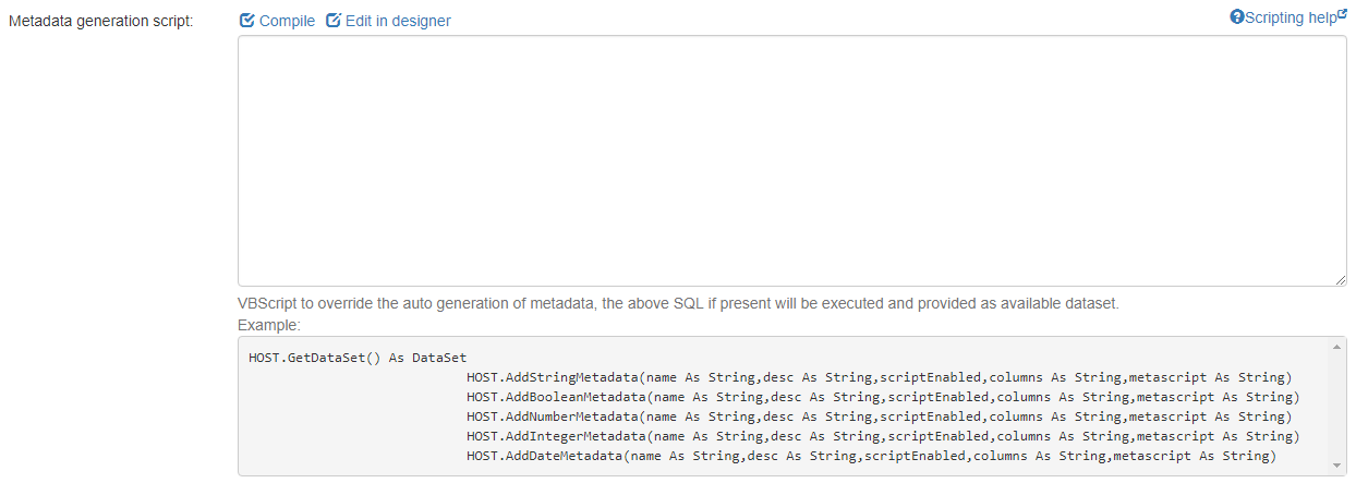

  1. On the Connectivity Hub page, click the content source name under Content. Click the Advanced tab.
  2. Scroll down to see Metadata Generation Script.
  3. Use the following HOST functions to generate the list of metadata properties that you require.

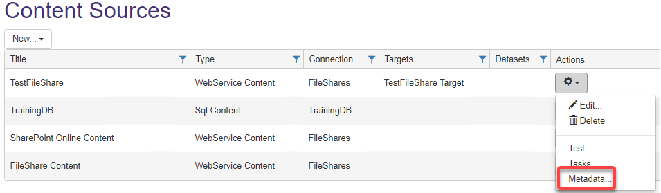

  1. Content Sources: Click the Content Sources link to see the Content Management page.
  2. Actions: Click Metadata for the content that you want to modify.

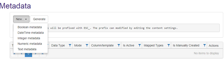

  4. New: Click New to select the type of metadata that you will use.

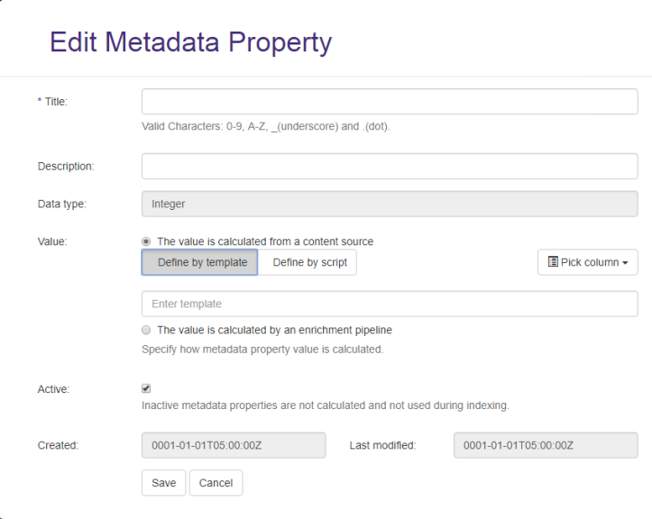

  5. The Edit Metadata Property dialog appears.

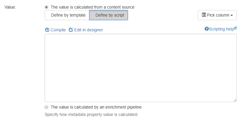

  6. Click Define by script in the Value field to access the scripting pane.
  7. Pick column: Select a property in the drop-down.
  8. Click the Compile link above the field to validate the script.
  9. Click Save to save your settings and return to the Metadata page.

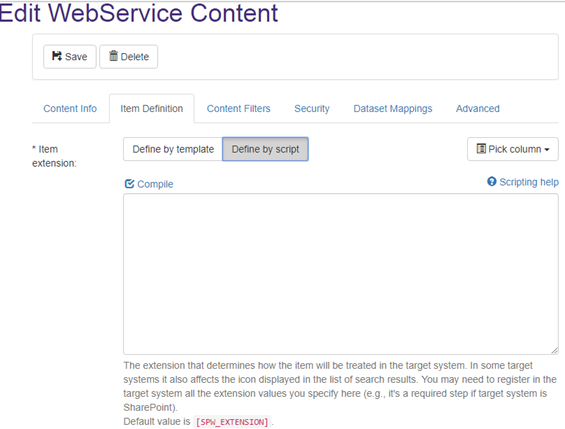

  1. Go to Content and click on a content type under Content.
  2. The <type of> Content page appears.
  3. Click the Item Definition tab and scroll down to see the required Item Extension box.
  4. Reference DS Columns with brackets(required): Make a selection such as SPW_EXTENSION.
  5. Advanced (required): Click the Advanced tab.
  6. Enter your script using the information provided above in this section.
  7. Compile: Click the Compile link above the field to validate and use your script.
