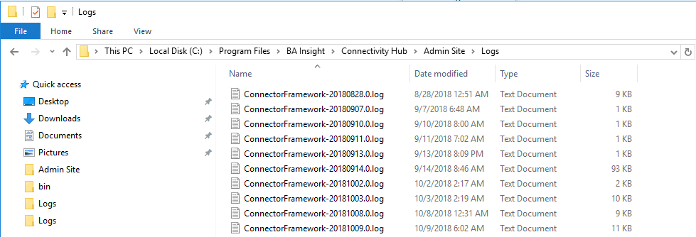

BA Insight provides a predefined configuration file for the administration site, Logging.config, which you can edit in Notepad to specify operations such as:
  • Specify parameters, like log level, buffer size and log file location
This operations are automatically applied when the logs are written.
  • To see or edit the Logging.config for the admin site, navigate to <ConnectivityHub_install_dir> > Admin Site > Logging.config
  • To see the log entries, navigate to <ConnectivityHub_install_dir> > Admin Site > Logs

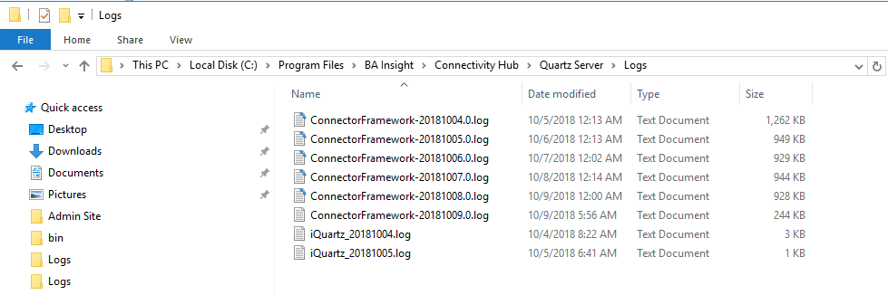

BA Insight provides a predefined configuration file for the scheduler serviceLogging.config, which you can edit in Notepad to specify operations such as:
  1. These operations are automatically applied when the logs are written.
  2. To see or edit the Logging.config for scheduler service, navigate to <ConnectivityHub_install_dir> > Quartz Server > Logging.config.
  3. To see the log entries, navigate to the folder where <ConnectivityHub_install_dir> > Quartz Server > Logs.

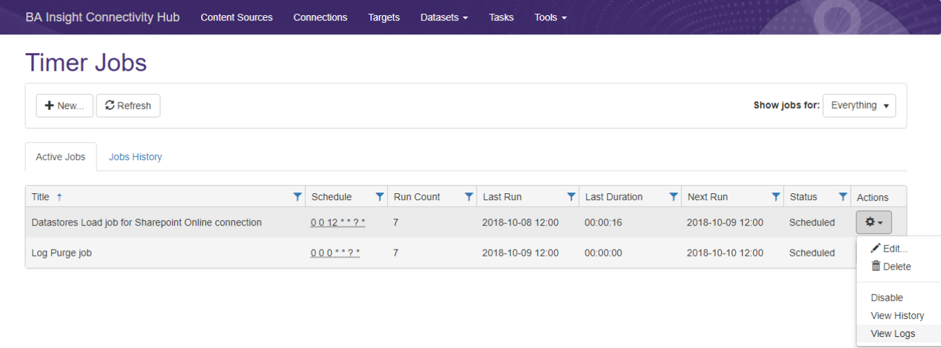

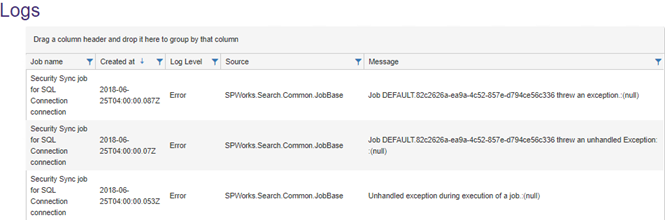

  4. Depending on the logging level selected while starting or scheduling a job, all or a part of the log entries can be seen from Admin Site > Tools > Logs
    See the Logs page.
  5. The information logged by each task in particular can also be seen from Tasks > Actions > View Logs.
