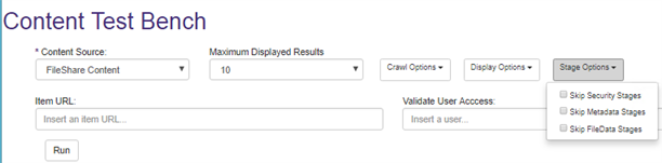

  • Depending on the stage description, specify at least one attribute that will define what area your stage affects.
  • For example, the TikaExtractor stage uses this tag: [AppliedProcessing(ProcessingTypeFlags.BlobProcessing)]
  • If you select Skip FileData stages from the TestBench, the Tika stage is be skipped.
