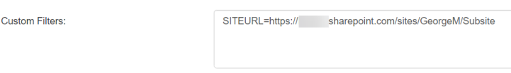

Datastores in the SharePoint Online v2 connector are site collections (the top-level sites) only, and not sites.
To support retrieving content from only specific sites, a SITEURL content filter can be used in the Custom Filters field.
Example

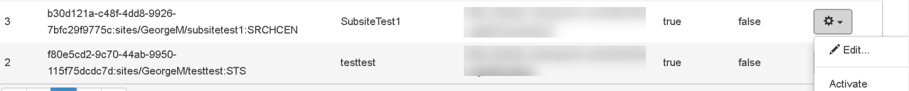

- In version 1, you can crawl a specific sub-site via the Datastores list (v1 below).
 - In version 2, this is configured in the content source using a custom filter (v2 below)
