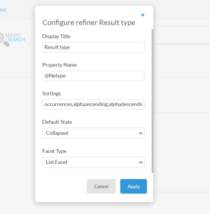

  • From the Edit refiners tab, the designer can create a new refiner and edit, or remove an existing one.
  • The refiners can also be reordered by drag and drop.

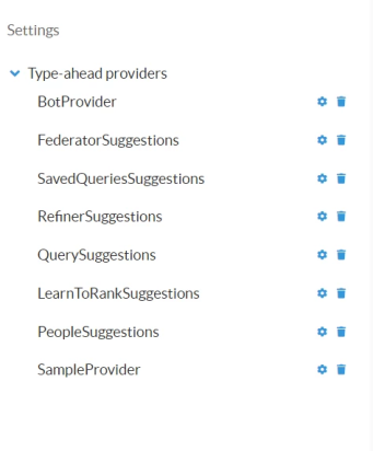

  • From the Customize type ahead tab, the designer can customize the available TypeAhead Providers.
  • More advanced customizations can be done by switching to the Advanced Mode and going to the Advanced settings edit tab.
