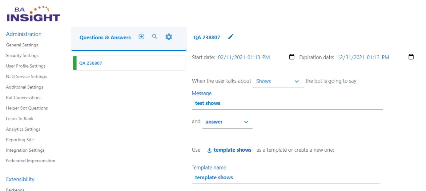

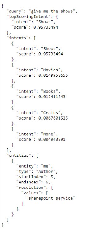

In the following example an NLQ query is performed for the phrase "give me the shows."
  • Query entities are shown in the code (shown below on the left)
  • A QnA entry exists for the intent "Shows." (shown below on the right)
Keywords
  • Keywords are shown in a query result document page, below.
  • The list of keywords is as follows:
    • give
    • shows
    • sharepoint
    • service
      Note: The word "sharepoint" is not highlighted in the screenshot below, because it is not found in the document.

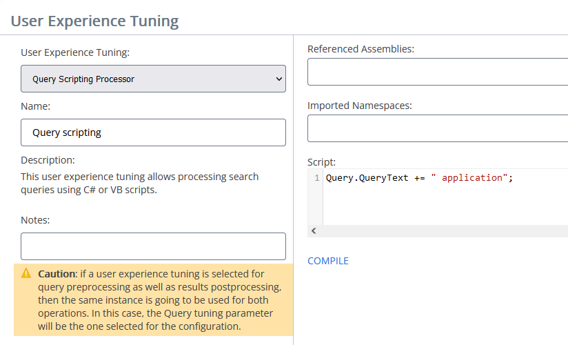

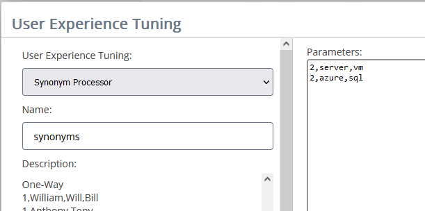

In the following example SmartHub Tuning stages are used to modify a query. A SmartHub search engine is configured with the following two query pipeline stages:
  • Query Scripting Processor
    • Modifies the query by appending at the end the "application" word:

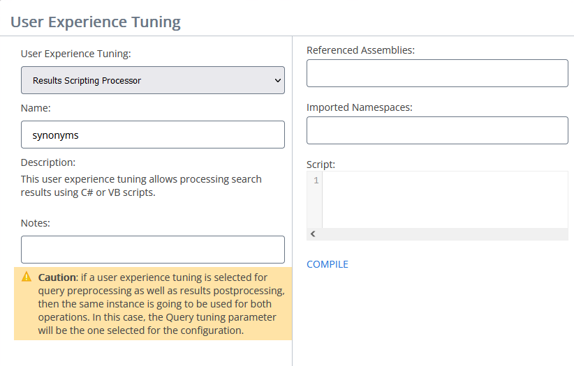

  • Synonym Processor
    • Sets the following synonyms:

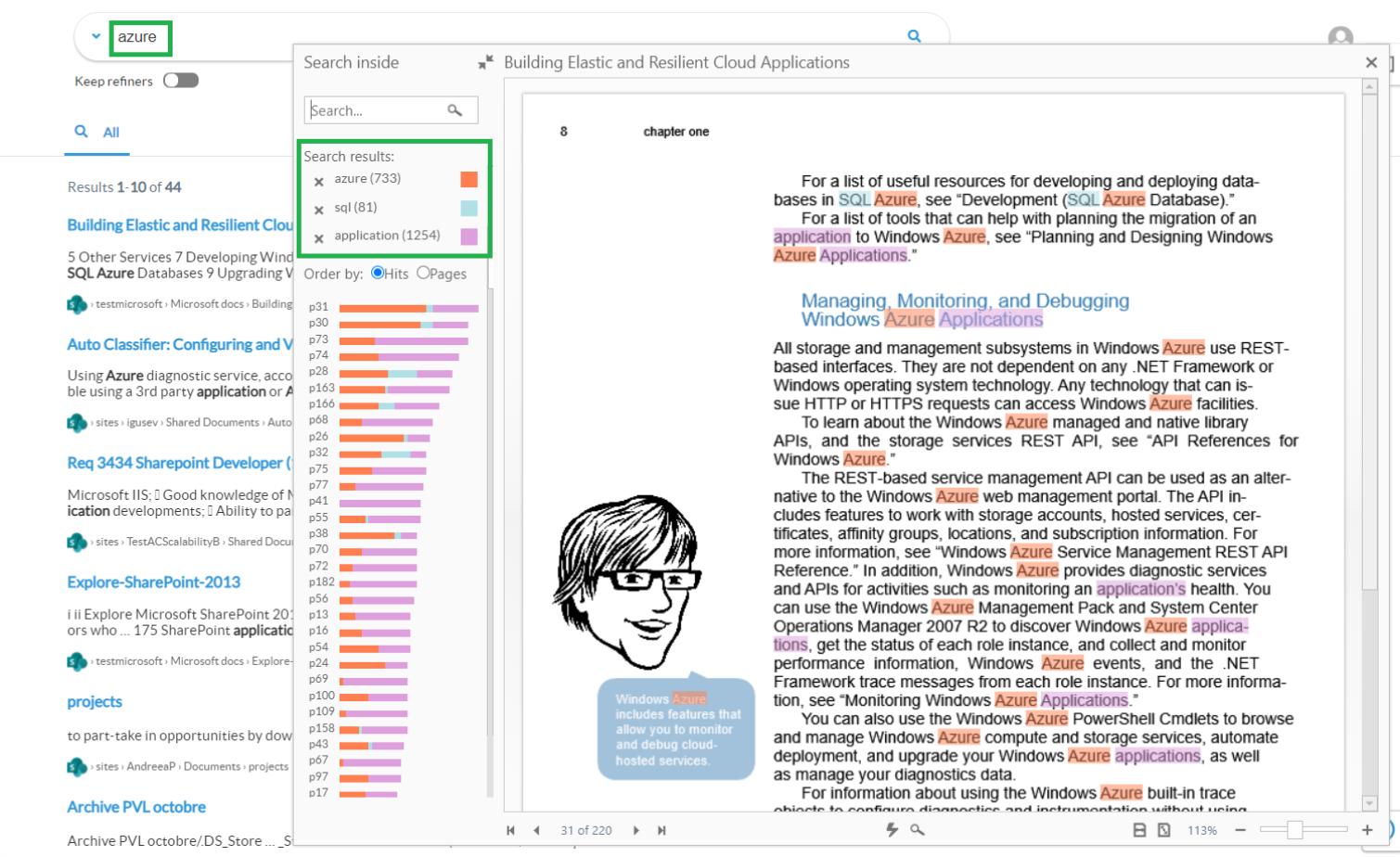

When querying the word "azure," a list of keywords are highlighted in the viewer that contain the following words:
  • azure
  • sql
  • application

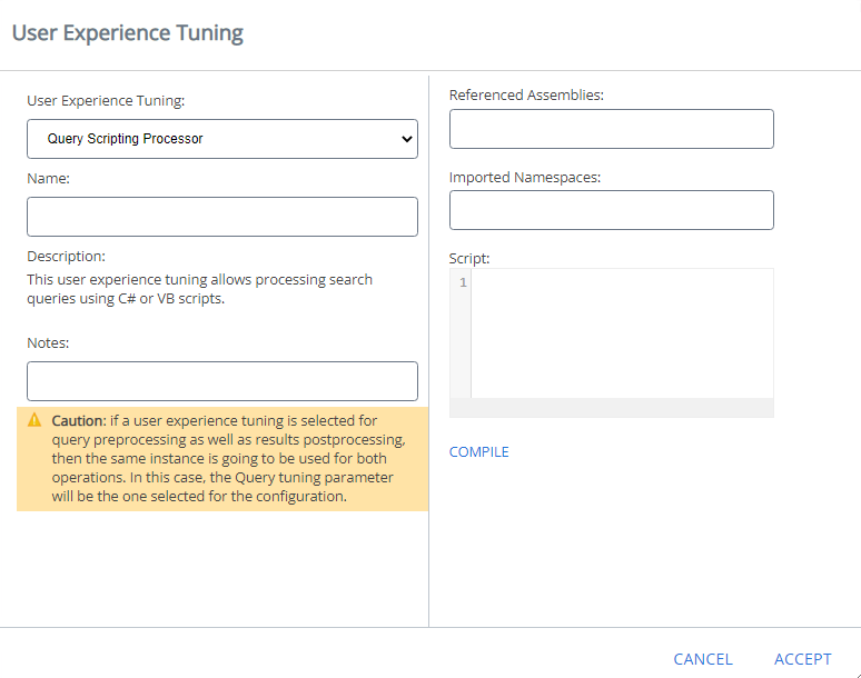

Add Additional Keywords through Scripting Stages
You can add custom keywords to be highlighted when opening the document viewer through the scripting stages.
  • Adding additional keywords can be achieved by adding any of the following Tuning stages:
    • Query Scripting Processor:
    • Results Scripting Processor:
