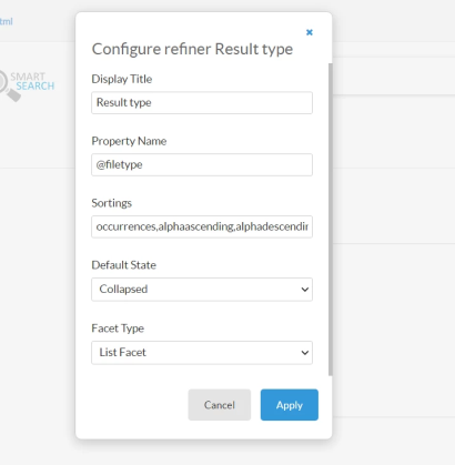

From the Edit refiners tab, the designer can create a new refiner and edit, or remove an existing one.
The refiners can also be reordered by drag and drop.

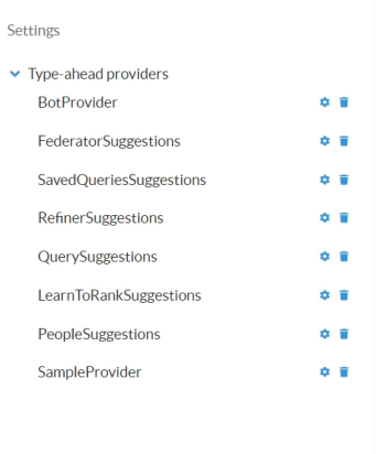

From the Customize type ahead tab, the designer can customize the available TypeAhead Providers.
More advanced customizations can be done by switching to the Advanced Mode and going to the Advanced settings edit tab.
