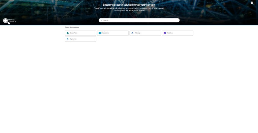

Landing.html
  • A jump off page where users enter their search query.
    • Alternative: Index.html
  • This file is overwritten when SmartHub is upgraded.
  • Note: You must point your SmartHub IIS site to load this file as the default starting page. See "How to Set SmartHub to Use a Custom Index or Landing Page" below.

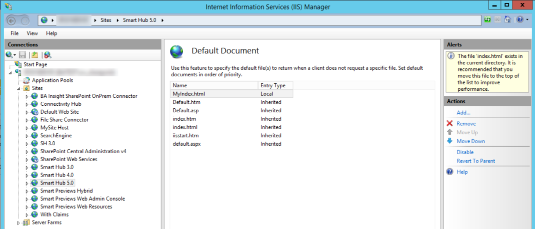

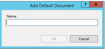

Follow the steps below to direct SmartHub to load your custom Index.html file ("MyIndex.html" in the example below):
Note: In the case of an upgrade, the setting of the "Default Document" from IIS is deleted.

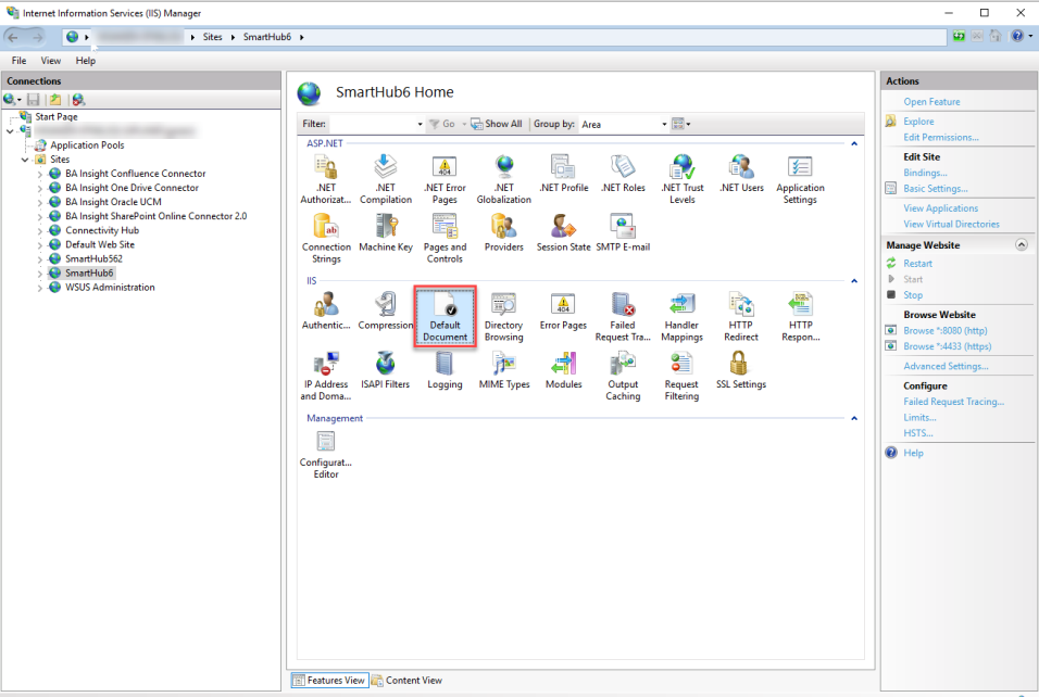

  • Follow these steps to reset the IIS "Default Document" for your SmartHub site.
  1. Locate your custom Index page file (by default, IndexCopy.html).
  2. Open Internet Information Services (IIS), and select your SmartHub site.
  3. Click "Default Document".
  4. Click the "Add" link under the Actions menu on the right side and enter the name of your custom Index file ("IndexCopy.html" or "MyIndex.html", for example) to add your index page as the default root page.
  5. Your custom Index file appears as the new default root page:

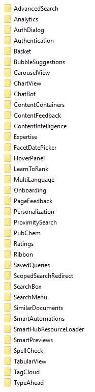

  • Each SmartHub component is found in its own directory, under \modules, as shown in the graphic below.
  • Each SmartHub component stores its settings in the same file: <SmartHub root>\modules\SmartHubResourceLoader\DefaultModuleSettings.js.
  • Component settings are used to change the behavior and/or appearance of the component.
  • To alter a component's settings, the settings are copied into the appropriate section of your custom settings file, and modified from there.
  • The custom setting file can be accessed from the UIBuilder in Advanced Mode via the Advanced Settings edit tab
