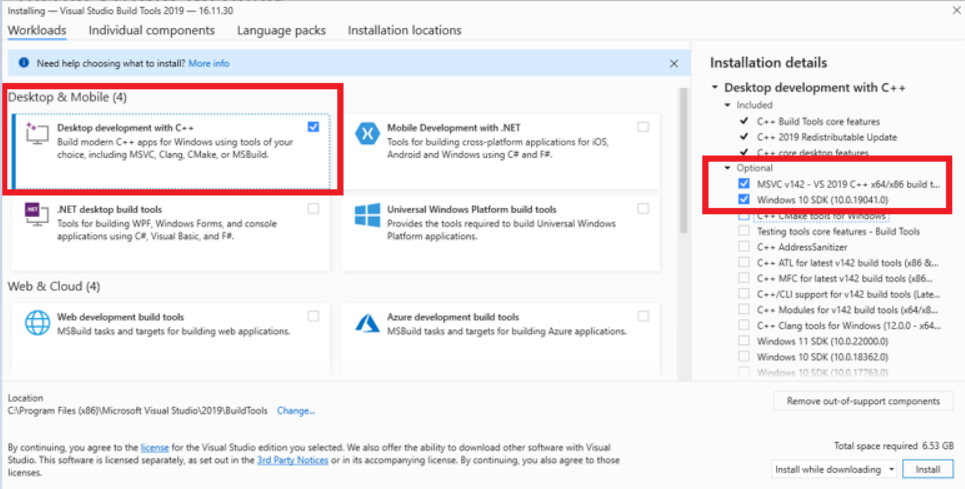

Download Build Tools for Visual Studio 2019
Double click the executable file downloaded.
Wait until the Build Tools is loaded.
Choose Desktop development with C++.
Choose MSVC v.142 – VS 2019 C++ x64/x86 build tools.
Windows 10 SDK
Click Install

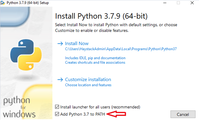

Double-click the executable file downloaded
In Python installation windows, select the check-box “Add Python 3.7 to PATH“
Click Install Now

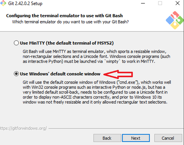

Press Next until you receive the window where you have this message: “Configuring the terminal emulator to use with Git Bash“
Choose “Use Windows default console window“ and continue to click Next until you have the Installation option

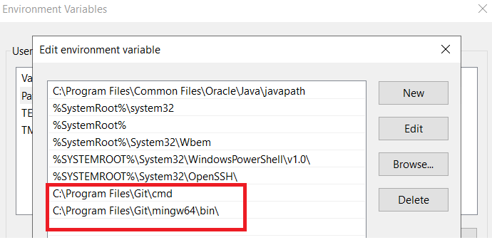

After the installation is done, you need to configure the system variable.
Right-click on "This PC"
Select Advanced system settings > Environment Variables...
Under System variables, select the "Path" row, click Edit, New, and add two paths:
Path to /bin folder from installation location (default: C:\Program Files\Git\mingw64\bin\)
Path to the Git command tool
In Environment variable you should have these 2 variables saved.

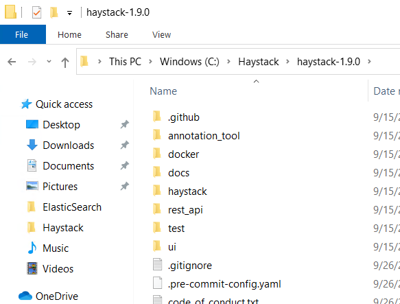

Create a new Haystack folder somewhere in your environment.
- Extract the contents of the .zip file to your Haystack folder.
- Using the cd command, navigate to the Haystack directory and into the root
- For example, cd "C:\Haystack\haystack-1.9.0"

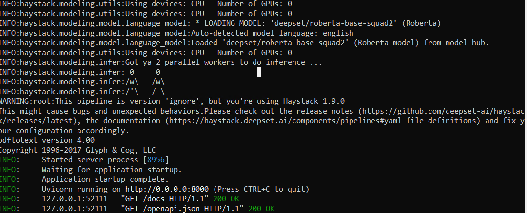

- Run the command:
uvicorn rest_api.application:app --host 0.0.0.0 - If everything is running correctly your command prompt should show something similar to this:
Verify Haystack is Running
To verify Haystack is running, use the following steps:
- Open the URL: http://localhost:8000/docs
- The Swagger API documentation for Haystack is displayed.
- This verifies Haystack is running.
