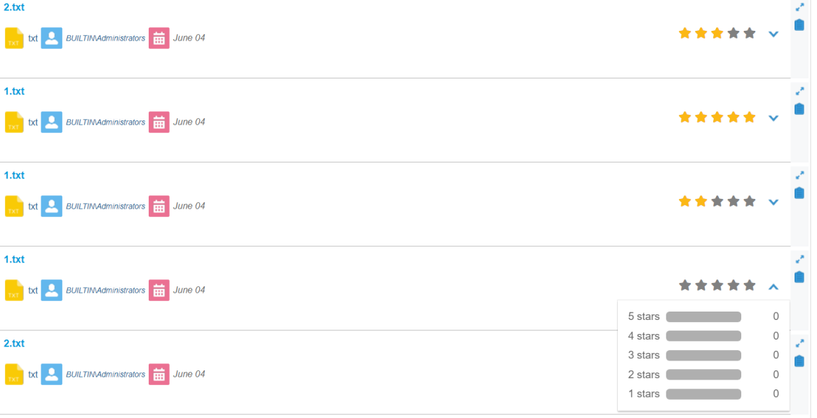

Stars
  • Users can rate documents with a number of stars.
    • The value is then registered by SmartHub Analytics.
    • Score averages are computed.
    • When the user runs a query, the Results page that appears displays the average rating of the items returned (if the items have been rated).
  • Grades go from 1 to a maximum grade value which is specified in the settings file (see below).
  • The Stars template also contains a detailed view with the count for each grade.

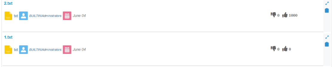

Likes
The "like" templates enables users to like or dislike documents.
The document later displays likes and dislike statistics.
  • A "like" is equivalent to the maximum defined grade from the settings file.
  • A "dislike" is equivalent to a value of "1".
Like/Dislike Ratings Example
An example rating of documents, complete with Likes/Dislikes, is shown below:
Stars Ratings Example
An example rating of documents, complete with Stars, is shown below:

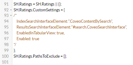

Ratings Code Example
Settings Example
SH.Ratings = SH.Ratings || {};
SH.Ratings.CustomSettings =
    IndexSearchInterfaceElement:".CoveoContentBySearch",
    ResultsSearchInterfaceElement:"#search.CoveoSearchInterface",
    EnabledInTabularView: true,
    Enabled: true
