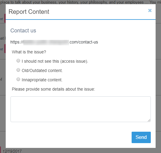

About Content Feedback
The Content Feedback competent can be used by users to report content issues.
The Content Feedback button  can be found in the action bar for each result.
Clicking the button opens a modal window that displays:
  • Result title
  • Result URL
  • The option to select the issue from three predefined issues:
    • Access issue
    • Old/Outdated content
    • Inappropriate content
  • The option to provide additional details about the issue with that result
  • Click Send to send an email using your local email client.
