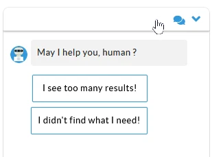

  1. Start interacting with the Bot by clicking Need any assistance? on the right side of the page:

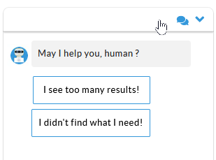

  2. See the expanded chat window:
  3. To refresh your available options click the chat bubbles icon in the top right of the bot window.

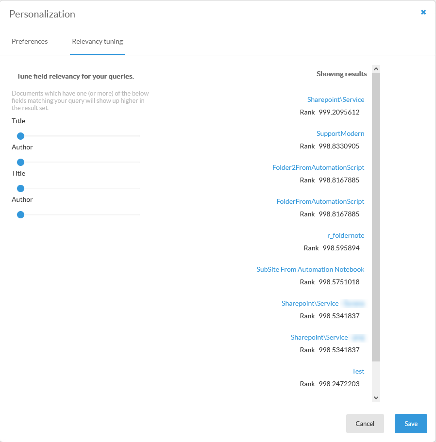

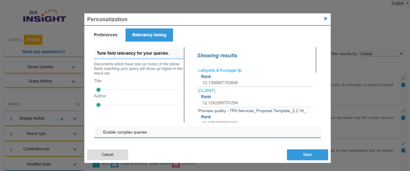

  4. Click the option "I didn't find what I need" and the Relevancy tuning dialogue is presented:
  5. Adjust tuning as necessary to improve search results. Note that adjusting each category slider affects the results in the "Showing results" column in real time.

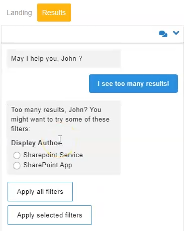

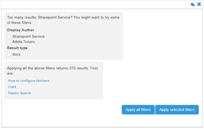

Too Many Results Returned - Filter Suggested
After some time without any user interaction, or after the user reaches a certain page, the Bot might suggest applying popular filters recorded with Analytics.
  1. The Bot window expands and displays the filters for the results.
  2. Filter your results by clicking one or more filters.
  3. At any time, dismiss the Bot to return the Bot to the side.

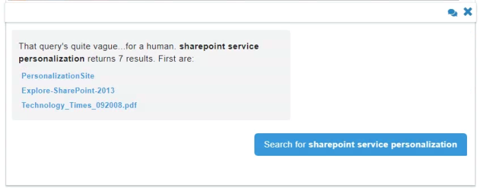

  4. Similarly, for a search query such as "sharepoint", the Bot might suggest a more specific query text based on analytics:

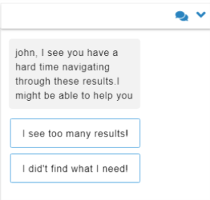

Bot Suggestions if User Pauses or Reaches End of Page
  1. After some time without any user interaction or if the user scrolls at the end of the page, the Bot might suggest tuning your search
  2. Based on the number of the displayed results, the bot opens the personalization panel or else suggest other similar queries run with success by other users.

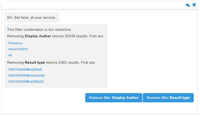

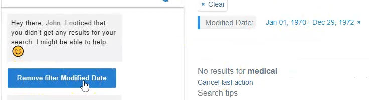

No Results Returned
If no results are returned, the Bot tries the following:

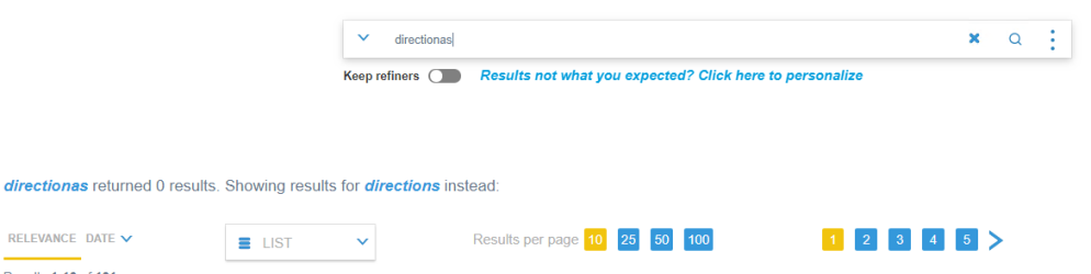

  1. Checking the query text for misspelled words using a word dictionary.
    1. For example, if the query is "directionas".
  2. If there are no query results or the query text appears to be incorrect, but some filters are active, the Bot suggests removing some filters in order to obtain results:

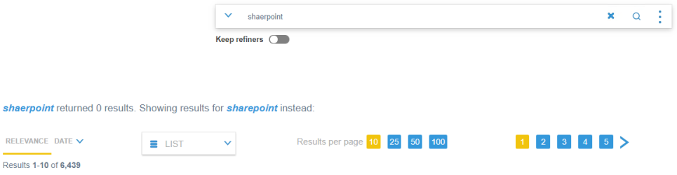

  3. If steps 1 and 2 fail (or are not applicable) then the Bot searches analytics for a common query term that is close to the original query term:
    1. For example, if the query is "shaerpoint" the Bot could return:
