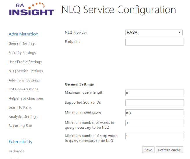

Rasa Settings
The NLQ Service Configuration page can be found by accessing theNLQ Service Settingspage from the Administrationpage:
Not every query reachesRasa.
By default, only querieswith at least 3 wordsreachRasa.
Note: At least 1 one the 3 words must be astop-word.
A built-in memory caches questions that are asked multiple times.
If the following settings are changed (such as lowering the value for theMinimum number of words in query necessary to be NLQ), then Rasa is called more often and the quota is reached faster:
  • Minimum intent score
  • Minimum number of words in query necessary to be NLQ
  • Minimum number of stop words in query necessary to be NLQ
The administrator needs to complete the following fields fromNLQ Service Configurationpage:
  1. Endpoint
    1. The endpoint to your Rasa model.
    2. For example: http://localhost:5000/parse?project=search_for_legal_documents8&q=
  2. Maximum query length
    1. Maximum query size.
  3. Supported Source IDs
  4. Minimum intent score
    1. Indicates the minimum prediction accuracy for intent.
    2. A prediction score is between 0 and 1.
  5. Minimum number of words in query necessary to be NLQ
    1. An integer.
  6. Minimum number of stop words in query necessary to be NLQ
    1. An integer.
    2. A stop word is a commonly used word (such as “the”, “a”, “an”, “in”).
