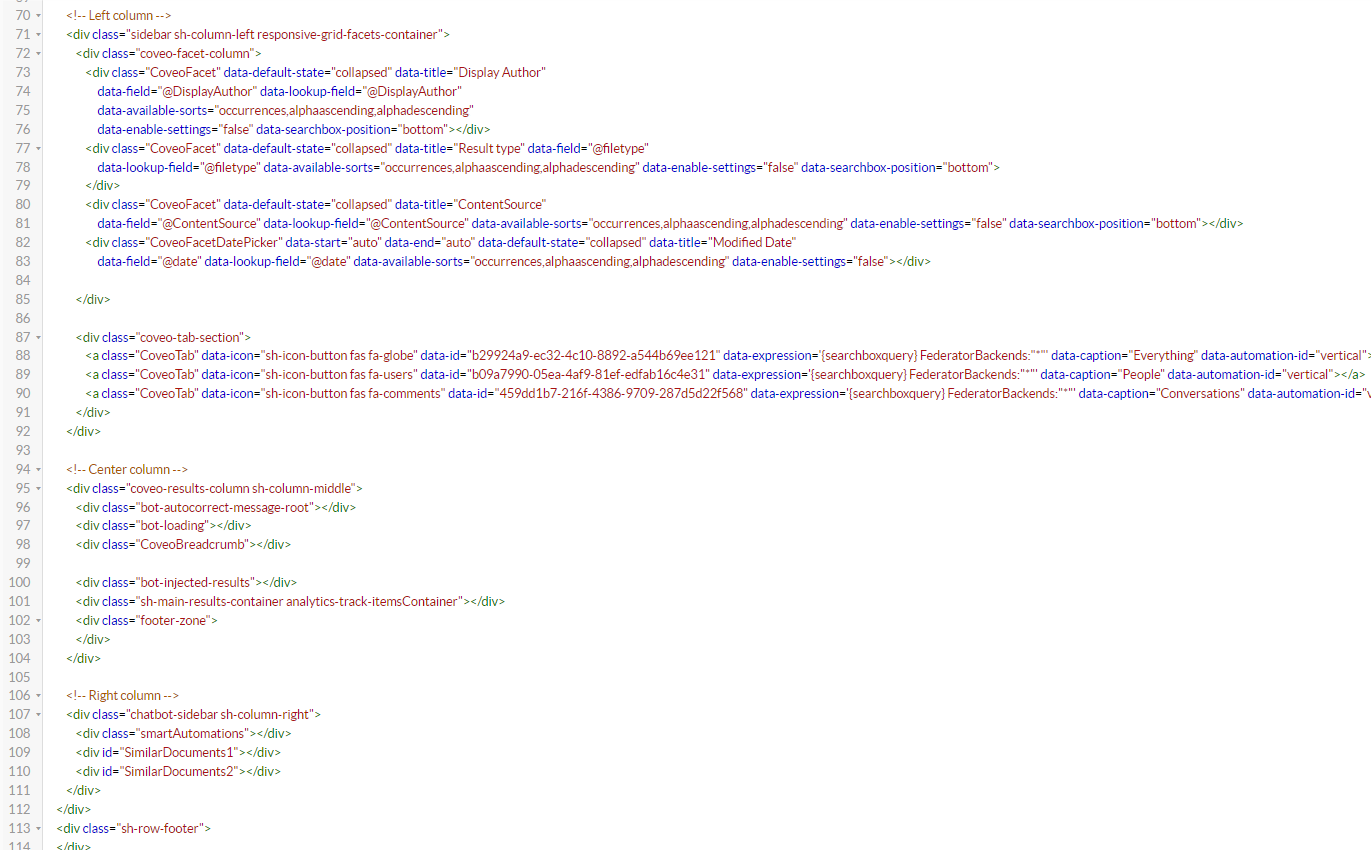

Left Column
  • Left column refiners are shown in the graphic below.
  • In your Results HTML file (or your custom Results HTML file), the left column refiners are defined around line 70, under the text <!-- Left column -->.
Refiners Shown in Left Column
Each field in the "sidebar" <div> class maps to the refiners available in SmartHub. See the graphics below. To add/remove/modify your refiners, use the UI Builder as described below.
Center Column
Center column refiners are defined around line 96.

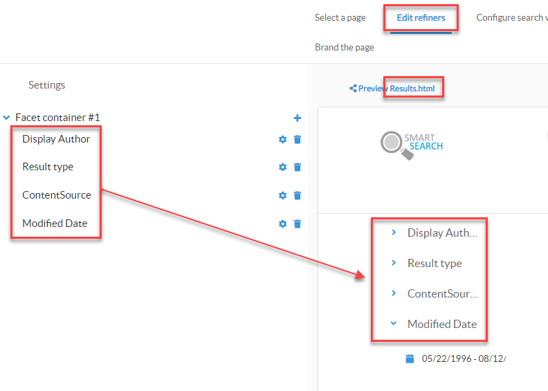

Add/Modify/Remove a Refiner Directly on the Results page
To add, remove, or modify a refiner to the Results page, use the procedure below. The easiest and fastest way to change the logo is via the SmartHub UI Builder.For information about how to access the UI Builder as well as who can access it, see How to Use the UI Builder.
Procedure:
  1. SmartHub administrators can simply click the UI Editor link from the SmartHub ADMINISTRATION page.
  3. Select the Results.html page.
    • Below, the Results.html page is shown for sample purposes.
    • BA Insight recommends you create your own custom page and folder to modify. Leave the default files as templates.
      • Example: pages/Results.html. The default Results.html page is under the top most SmartHub directory.
  4. Select Basic mode from the top right of the page.
  5. The refiners shown on the Results page correspond to the Settings pane at left.
  1. Click the "+" icon to add a refiner.
  2. Enter a Display Title and Property Name.
  3. Select the rest of the refiner options.
  4. Click Apply.
  5. Click Save changes.

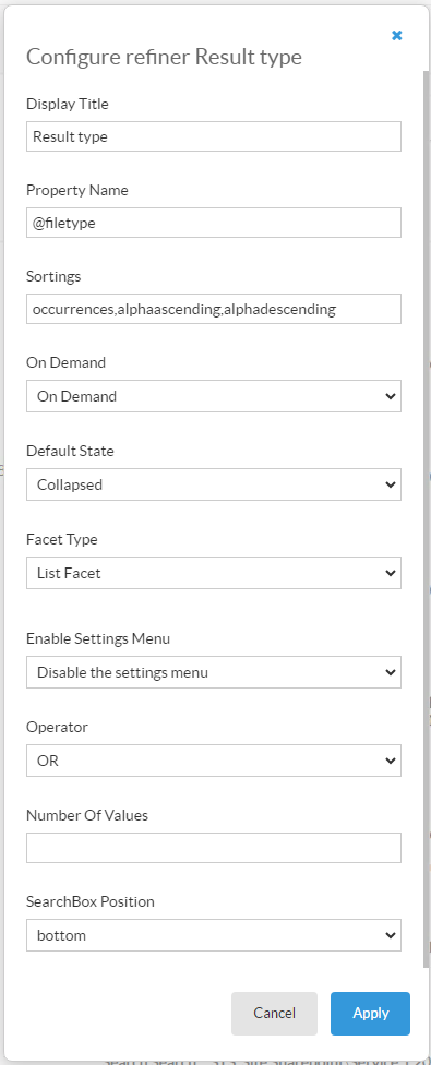

Modify a Refiner
  1. Navigate to the Refiner settings using steps 1-7 in the procedure above.
  2. From the Settings pane, click the settings sprocket icon next to a refiner (Facet container).
  3. Use the drop-down menus to modify refiner settings.
    • Note that changing a field - Facet Type, for example - causes new fields to appear with additional settings.
  4. Click Save changes.
  5. Launch SmartHub and confirm the refiner appears in the list of available refiners.
