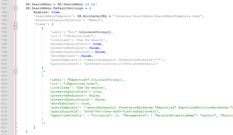

  7. Scroll down to around line 169.
  8. To access the available SearchMenu settings, click the See Default Settings link in the top right corner.
  9. A new browser tab opens with all available SmartHub module settings.
  10. Search for the word "SearchMenu" on the page to quickly navigate to the SearchMenu settings, shown below:
  11. Copy the SearchMenu settings section.
  12. Go back to your Advanced settings edit tab.
  13. Paste the copied settings inside the section SH.SearchMenu.CustomSettings.
    1. Note the Template file referenced (line 789 in the image above)
    2. To modify the SearchMenu template, see "How to Customize the Template, below"
