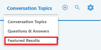

  1. Click on "Conversation Topics" under "Bot Conversations" .
  2. Select "Featured Results/Questions & Answers".
  3. Click the "+" icon at the top left of the screen.
