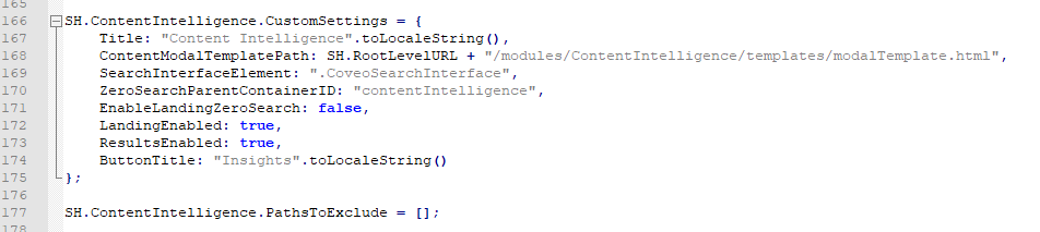

  11. Copy the ContentIntelligence settings section from SH.ContentIntelligence.DefaultSettings.
  12. Go back to your Advanced settings edit tab.
  13. Paste the copied settings inside section SH.ContentIntelligence.CustomSettings.
  14. Modify settings as desired. Refer to the "Content Intelligence Settings" table below.

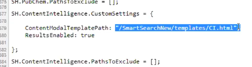

  • Changing the modalTemplate.html filename requires the new file to be declared and defined in any custom page settings files.
  • For more about custom files, see How to Use the UI Builder.
Example
  • For example, in the custom Results page settings file example below, CI custom settings (SH.ContentIngelligence.CustomSettings) are stored in a modal template file named CI.html in a custom directory (/SmartSearchNew/templates/CI.html).
  • This custom file is not overwritten when SmartHub is upgraded.

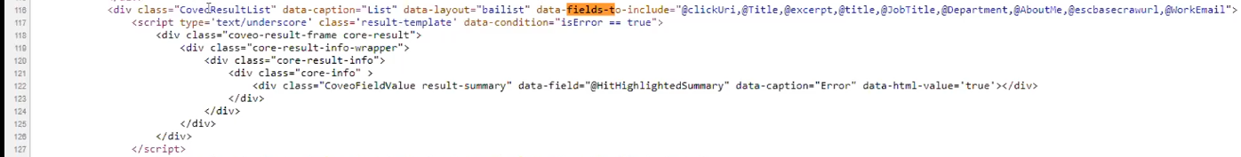

  • Properties listed in your Results or custom Results HTML page.
    • The parameter "data-fields-to-include" (shown below) contains the list of data fields shown in the UI.
      • Some values are provided by default (around line 126).
      • See the example and graphic below.
Example
Below is an example which contains:
  • Class "CoveoResultList" which contains "data-fields-to-include,"
    • "data-fields-to-include": includes the properties made available in CI.
      • Properties are entered as a comma-separated list, each preceded by an '@' character.
      • Any fields in your modalTemplate.html file that are NOT included in the "data-fields-to-include" comma-separated list, are not populated with values in CI, even if the properties exist in your index.

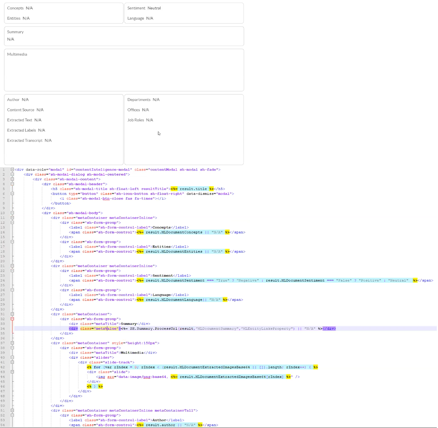

Example: Content Intelligence Template
The CI example below contains:

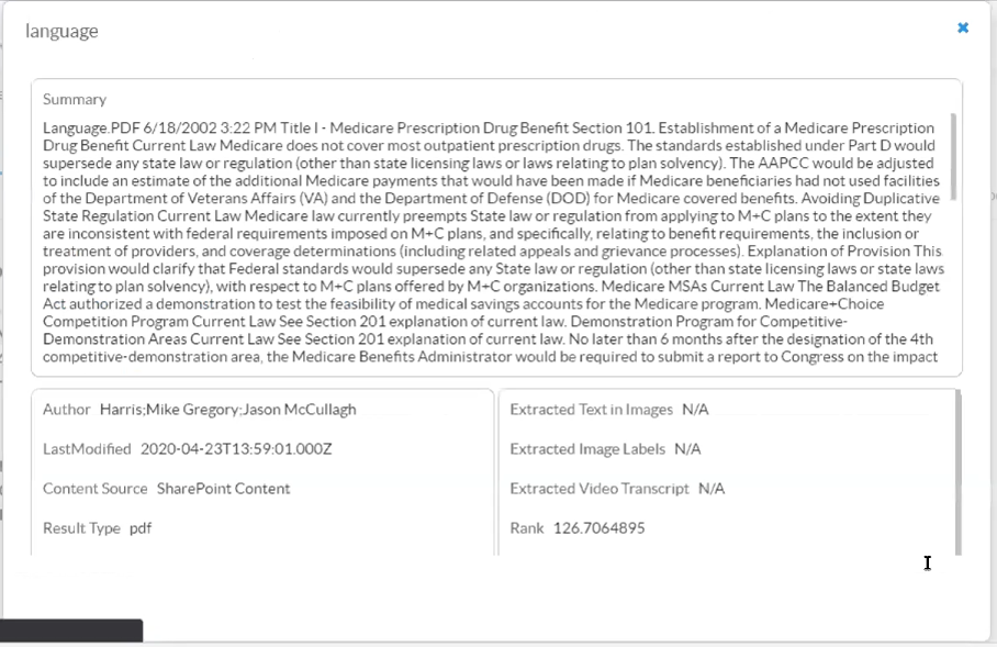

  • Sections with values: A "metaContainer" class, shown below with label "Summary."
    • Can also contain titles (div class "metaTitle") and values (div class "metaValue") under the section.
  • Form Groups: Such as the box that includes the metadata labels:
    • Author
    • Last Modified
    • Content Source
    • Result Type
  • Labels: Such as "Author," "Extracted Text in Images," "Content Source," and so on.
  • Values: Attached to Labels below, such as "SharePoint Content," "pdf," "2020-04-23T13:5901.000Z," and so on.
Content Intelligence Example With HTML Source Code

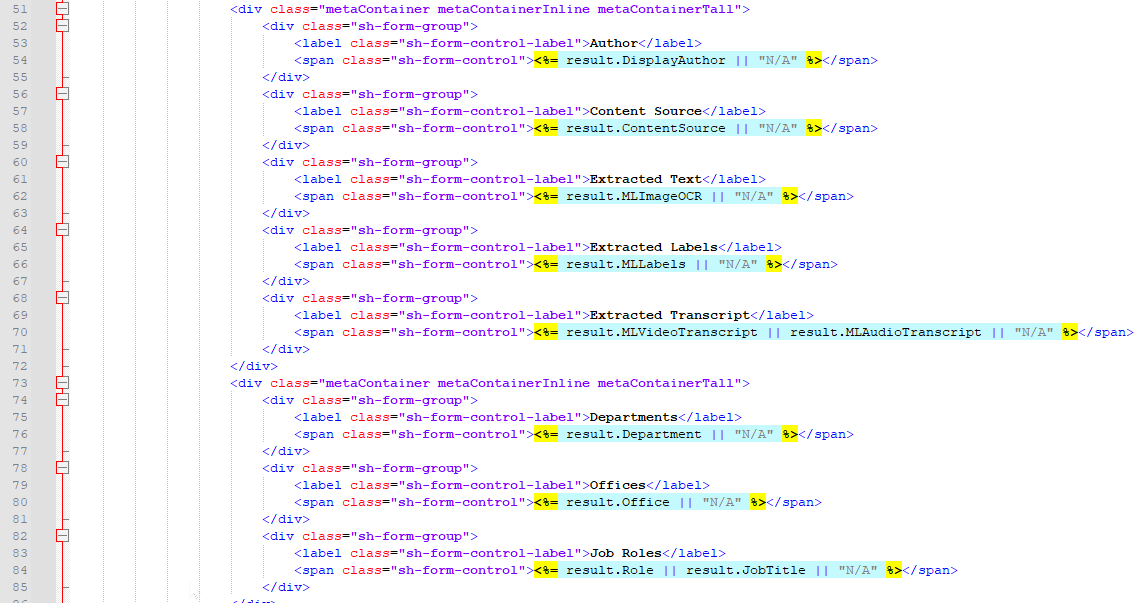

Below is another modalTemplate HTML file with various CI classes, Sections, Form groups, Labels, and Values, and the corresponding user interface provided to the user.
Note: In the screenshot below, the fields are shown for example purposes.
They are not populated.

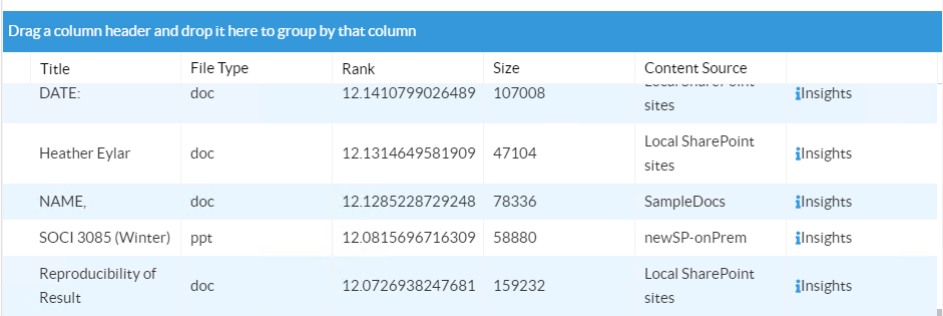

  • In the screenshot of a ZeroSearch frame below observe the following:
    • Advanced Search functions appear on the left
    • When query text and options are selected, and the Search button clicked:

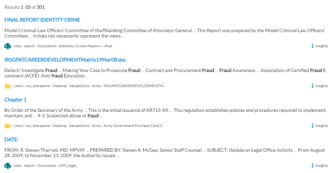

      • On the right side, under Search preview, the top search returns are displayed.
      • A Content Intelligence "Insights" icon is displayed for each returned result.
      • Selecting the "Insights" link under each returned item displays the Content Intelligence properties described above.

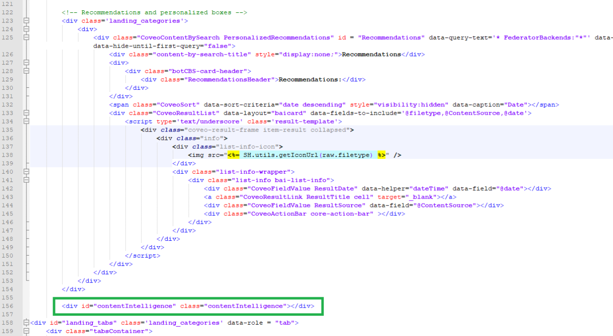

  1. Open (or create) your custom Index HTML page.
    • For example: <SmartHub_root>\IndexCustom.html.
  2. Choose a location where you want the Content Intelligence ZeroSearch element to be rendered and add the following code:
    Note: Where you place the code affects where on the page the ZeroSearch box appears. In the example below, the ZeroSearch box appears on the bottom of the Index page.
    <div id="contentIntelligence" class="contentIntelligence"></div>

    See the screenshot below as an example.
  6. Change the following settings:
    1. ZeroSearchParentContainerID: If you choose another ID for your <div> element at step 2, change this setting to contain that ID.
    2. EnableLandingZeroSearch: Set to true.
    3. LandingEnabled: Make sure this setting is set to true.
    4. Title: Optional. Add a new title for your element.
  7. Ensure the code is valid, well-formed, and all tags are properly opened and closed.
  8. Save and close all files.
