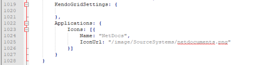

  • This is a JSON object that can be used to configure additional (tag, icon URL) pairs to be used in the component's Application column to showcase what applications a specific SmartAutomation uses behind the scenes.
  • Example:
    (If an AppBus flow refers to the NetDocstag then the corresponding Icon URL is used)

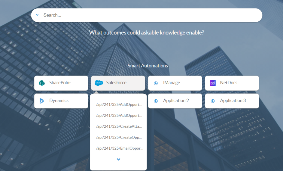

How to use smart actions in carousel style
If there is no category defined, a carousel with all the available actions is shown:

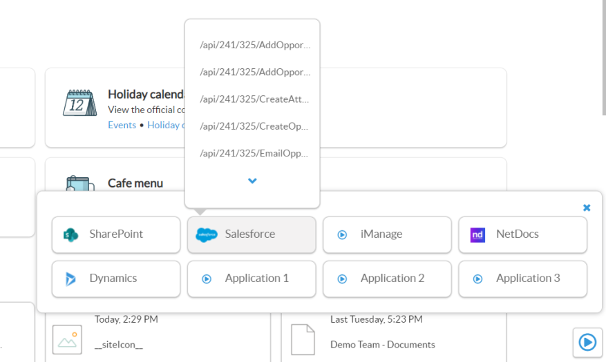

How to Add Smart Actions to a Search Results Page
The Smart Automation module can also be displayed as a flyover by changing the ShowAsFlyover setting to true.
  • BA Insight recommends you set Smart Automations as a flyover if you want to add the module on a search results page.
