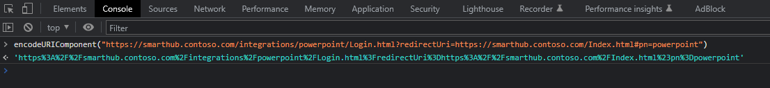

URLs can be encoded by opening a Browser Console (F12) and applying encodeURIComponent function to desired URL:

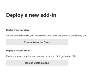

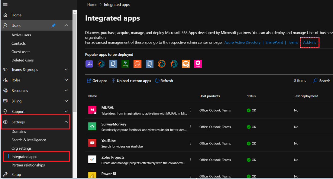

  1. Access the Services & add-ins page as an Administrator: https://admin.microsoft.com/AdminPortal/Home#/Settings/AddIns
  2. Click the Deploy Add-in button.
  3. Click Next.
  4. Click Upload custom apps.

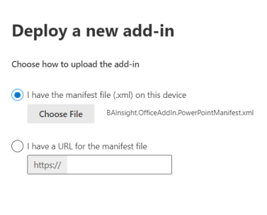

  5. Select "I have the manifest file (.xml) on this device."
    1. Click Choose File and browse to the .manifest file delivered with the SmartHub package.

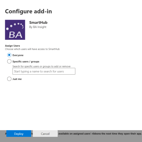

  7. Asign Users (Everyone).
  8. Click the Deploy button.
  9. From this point, the Hub is available to all of your users.

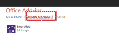

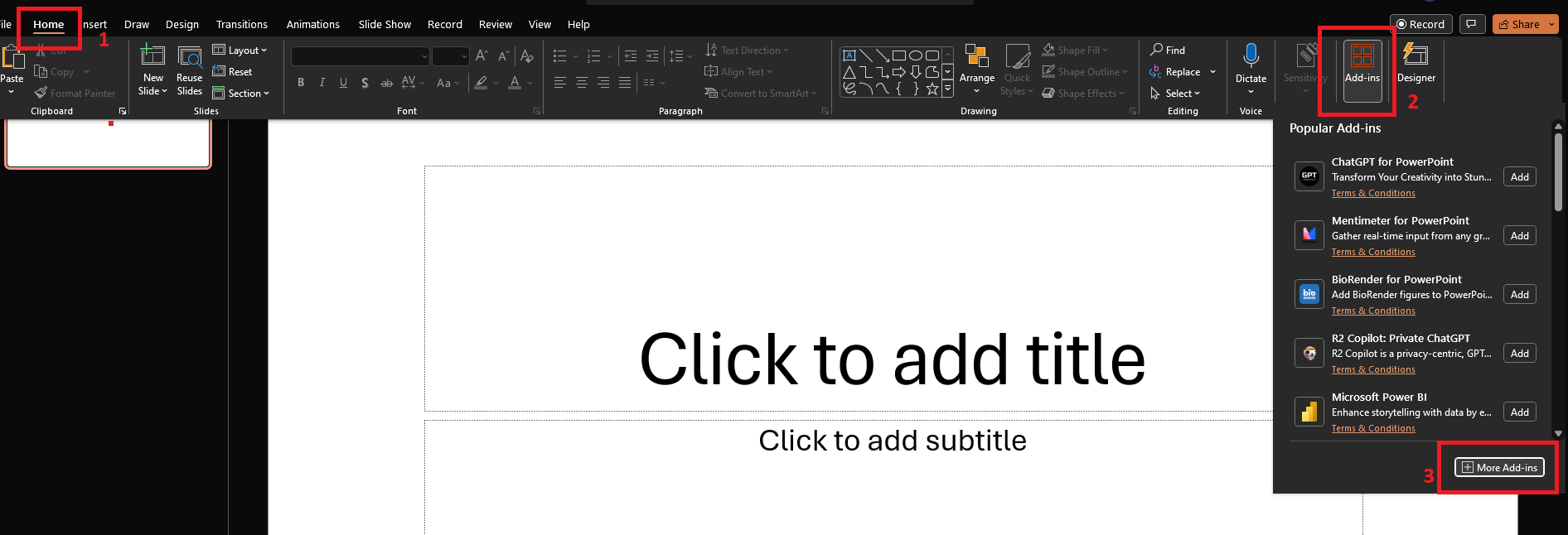

How Users Enable SmartHub in PowerPoint

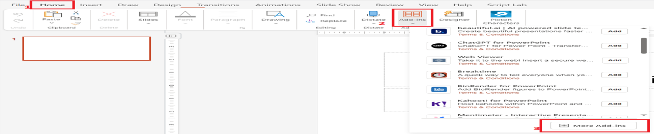

  1. Users can enable SmartHub in their PowerPoint instance by going to Home > Add-ins > More Add ins > Admin managed and add "SmartHub ".

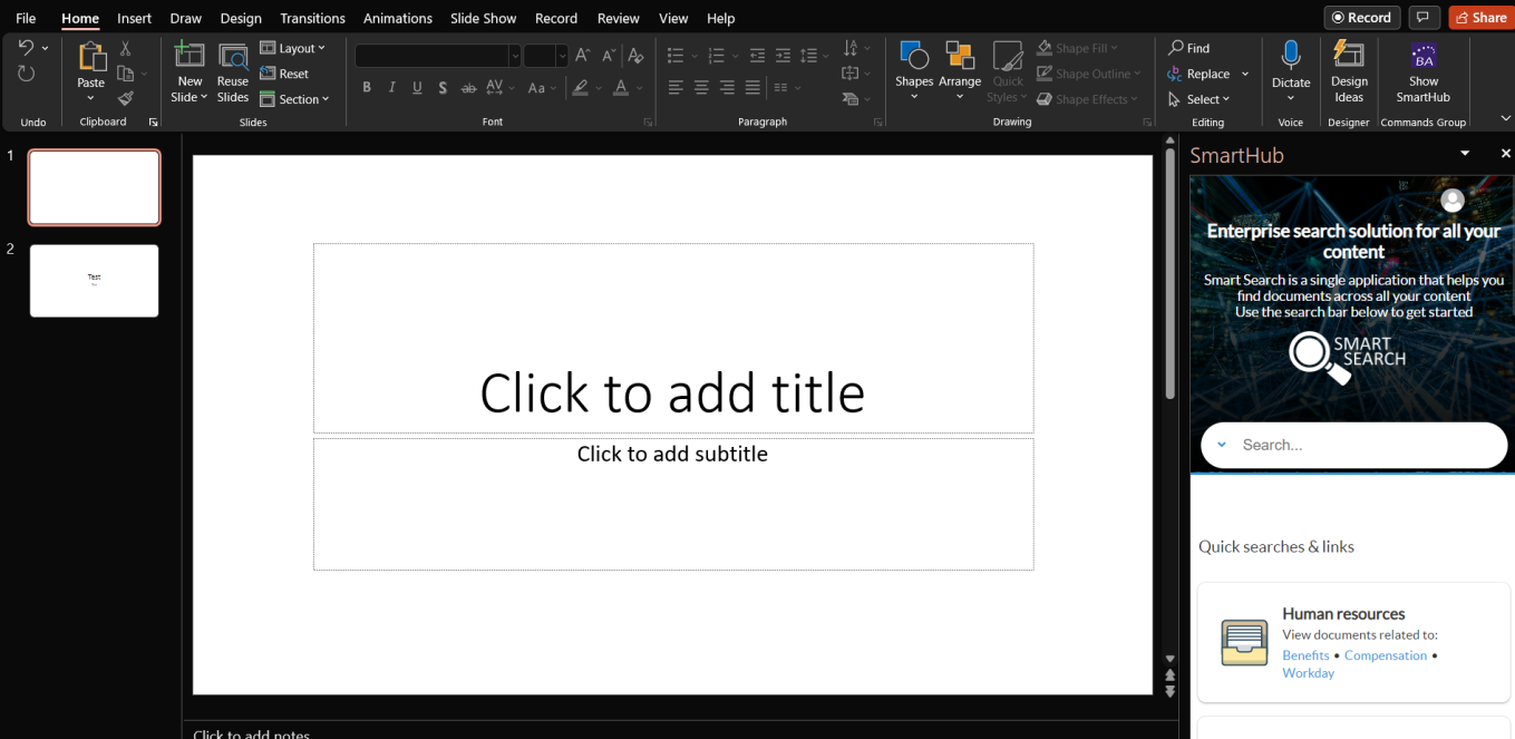

  2. The SmartHub button can be found in PowerPoint > Home > Show SmartHub.

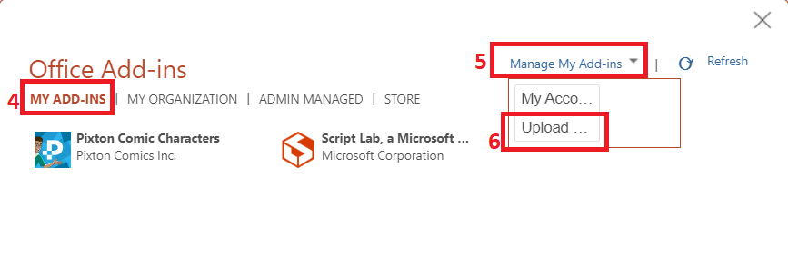

How to Install PowerPoint Add-In (Independent)
  1. Go to PowerPoint 365 (it works only for PowerPoint browser version).
  2. Open a presentation.

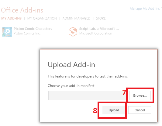

  3. From the menu bar, Select Insert > ... > Add-In > MY ADD-INS > Upload My Add-in > Browse. Select the Manifest file and click Upload.
  4. After these steps, you should be able to access the SmartHub from your presentation.
