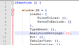

  1. Go to the  DefaultModuleSettings.js file and scroll down to the logLevel parameter, around line 75.
  2. Copy the logLevel parameter and value into your custom settings file such as ResultsCustomSettings.js in the "AnalyticsSettings" section (see below).
    For more about using custom settings files, see How to Use the UI Builder.
  3. Change the value of the logLevel parameter using the following log settings:
