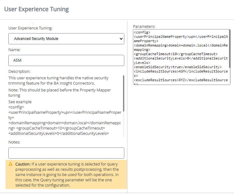

Add the Advanced Security Module Tuning Stage
To use the Advanced Security Module, you must add a Tuning stage.
Use the following steps to add the ASM Tuning stage.
Caution: This stage must be the first stage executed among your search engine tuning stages.
  • You can change the order of the stages by using the up and down arrows.
Applies to content secured with Active Directory users and groups:
  • If you're using Advanced Security Module to secure content from a Connector which relies on Active Directory for users and groups, such as (FileShare, FileNet, SharePoint), you must set "enableSidSecurity" to "true".
  • See more details in the configuration table below.
  1. Navigate to the SmartHub Administration page at http(s)://[web-app-url]/_admin.
    • For example: http://smarthub.azurewebsites.net/_admin
  2. Click on the search engine which should be secured.
  3. Click ADD QUERY TUNING.
  4. User Experience Tuning: Use the down arrow to select Advanced Security Module.
  5. Name: Complete a name for your stage.
  6. Parameters: Copy and paste the following code, replacing the sample values with the appropriate values.
    <config>
        <userPrincipalNameProperty>upn</userPrincipalNameProperty>
        <domainRemapping>domain=domain.local</domainRemapping>
        <groupCacheTimeout>10</groupCacheTimeout>
        <additionalSecurityLevels>0</additionalSecurityLevels>
        <enableSidSecurity>true</enableSidSecurity>
        <includeResultSources>ASM</includeResultSources>
        <excludeResultSources>XYZ</excludeResultSources>
        <impersonateUser>domain\uA=domain\uB</impersonateUser>
        <debug>false</debug>
        <showErrorWhenCHNotAvailable>true</showErrorWhenCHNotAvailable>
    </config>

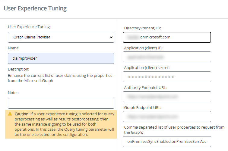

  • If SmartHub is configured to use Azure AD Authentication and you want to pass the onpremise sid for security validation, then specify the onprem_sid value for userPrincipalNameProperty
    • <userPrincipalNameProperty>onprem_sid</userPrincipalNameProperty>
