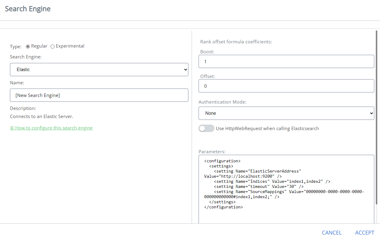

  2. From the General Settings page click ADD NEW SEARCH ENGINE to add your new Elasticsearch search engine.
  3. Type: Select Regular
  4. Search Engine: Select Elastic or AWS Opensearch (for AWS-hosted Search service) from the drop-down list.
  5. Enter the search engine Name and corresponding information in the appropriate fields, as shown in the following image:
  6. Rank offset formula coefficients(Optional): Enter these values only if you selected the Rank Based mixing algorithm that is set in the Properties for the SSA page:
    • BOOST: Enter the boost factor.
    • OFFSET: Enter the rank offset.
  7. From the Authentication Mode field, select the authentication mode for your environment's Elasticsearch type from the drop-down menu. The possible authentication modes are:
    • None
    • Basic
    • Token Based
  8. Enter your credentials that are used to access Elastic Search service, based on the search engine you selected in step 4.

  9. Modify the search engine configuration by entering your configuration settings into the Parameters field.
    See the following example code:
    Search engine configuration example
    <configuration>
        <settings>
            <setting Name='ElasticServerAddress' Value='http://localhost:9200' />
            <setting Name='Indices' Value='index1, index2' />
            <setting Name='Timeout' Value='30' />
            <setting Name='SourceMappings' Value='00000000-0000-0000-0000-000000000000#index1,index2;' />
        </settings>
    </configuration>
