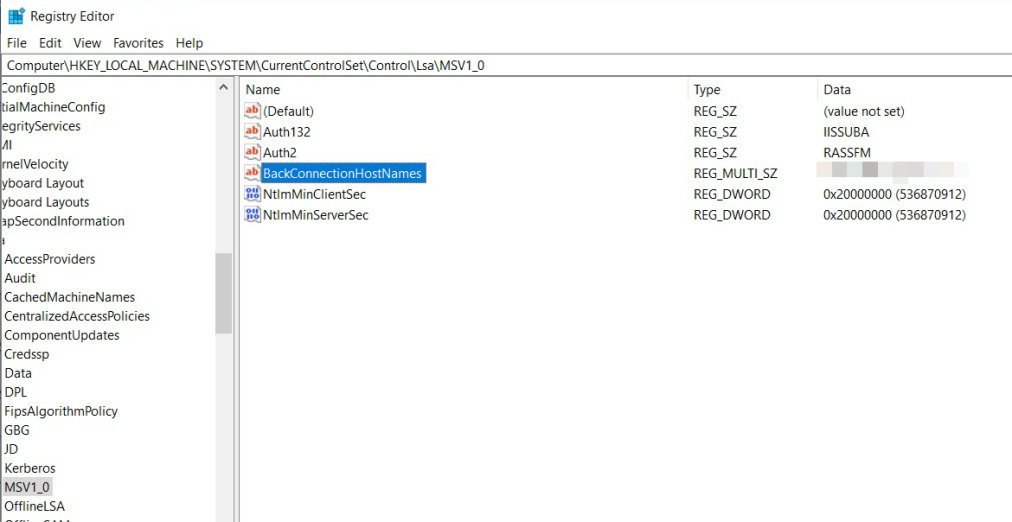

  1. On the machine housing SmartHub a registry key needs to be modified using regedit:
    1. Launch regedit. You must use caution, these settings can modify your computer in critical ways.
    2. Go to the following path: Computer\HKEY_LOCAL_MACHINE\SYSTEM\CurrentControlSet\Control\Lsa\MSV1_0
    3. The entry Lsa\MSV1_0 already exists. You simply need to add a new entry: BackConnectionHostNames
    4. Manually add a multi-value entry with the name BackConnectionHostNames populated with the hostnames you want to use.
