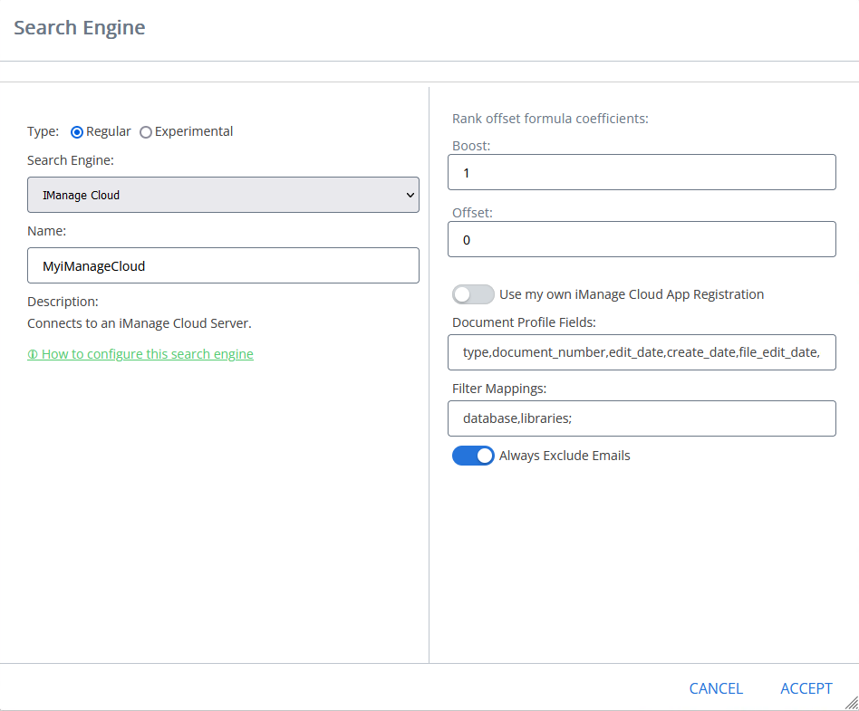

How to Configure an iManage Search Engine
  1. Navigate to the SmartHub Administration page at: http(s)://[web-app-url]/_admin
    1. For example: http://smarthub.azurewebsites.net/_admin
  2. Go to the General Settings page.
  3. Add New Search Engine: Click the "Add New Search Engine" link to add your new iManage search engine.
  4. Type: Select regular
  5. From the dropdown list, select iManage Cloud.
  6. Next, enter the Name and corresponding information in the appropriate fields.
  7. If you desire, you can use your own iManage App registration, however, this is not recommended. Upland BA Insight recommends using the default app registration. For more information, see the note regarding redirect URLs above.
  8. Note: When registering the app you need some specific Redirect URLs.
Use the following table:

Procedure:
Use the following steps to configure your iManage results clicking behavior:
  1. Go to iManage search engine settings.
  2. In the Document Profile Fields field, add the characters "iwl".
  3. In your SmartHub settings file, and add FieldsToInclude from ContentContainers to the MainResults "iwl" property
