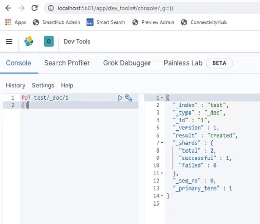

  1. Go to your Kibana Dev Tools.
    1. URL (or similar): http://localhost:5601/app/dev_tools#/console?_g=()
  2. Enter this command and run it:

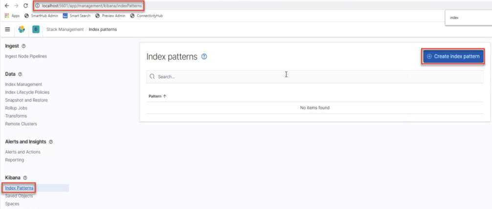

  3. Open Stack Management → Index Patterns:
    1. URL: http://localhost:5601/app/management/kibana/indexPatterns
  4. Create an index pattern based on index:
    1. Click "Create Index pattern."
    2. In the Index Pattern text box, enter "test". NOTE: The field is case-sensitive.
    3. Click the Next step button.
    4. Click "Create index pattern"

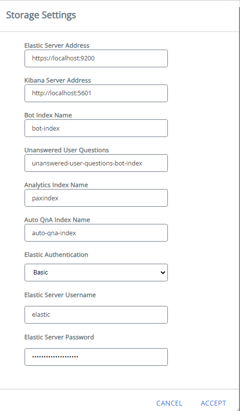

  1. Navigate to the SmartHub Administration page by going to http(s)://[SmartHub-web-app-url]/_admin.
  2. In the General Settings section, click Edit next to Storage Settings.
  3. Complete all the following fields:
    1. Elastic Server Address: This is the URL of your Elasticsearch server, including port number. The default value is http://localhost:9200.
    2. Kibana Server Address: This is the URL of your Kibana server, including port number. The default value is http://localhost:5601.
    3. Bot Index Name: This is the name of your bot index. The default name is bot-index.
    4. Unanswered User Questions index name: This is the name of your unanswered user questions index. The default value is unanswered-user-questions-bot-index.
    5. Analytics Index Name. This is the name of your analytics index. The default value is paxindex.
    6. Auto QnA Index Name: This is the name of your auto QnA index. The default value is auto-qna-index.
    7. Elastic Authentication: Choose and configure the desired authentication mode.

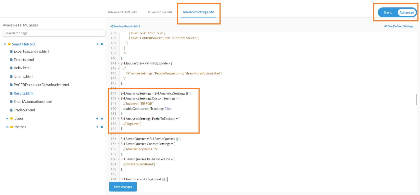

How to Modify the Analytics Settings
To modify the analytics settings, you need to access the UI Builder. For more information, see How to Use the UI Builder.
  1. Select the page that youwant to add/modify the analytics settings for.
  2. Select the Advanced mode.
  3. Select the Advanced settings edit tab.
  4. Locate the analytics settings section around line 147.
  5. Add/Modify your setting(s) under the SH.AnalyticsSettings.CustomSettings block.
    Note: When clicking on the See Default Settings button from the upper right corner, a new tab opens that displays all the default settings for the SmartHub modules.
    Locate the analytics settings section to see the default values that are used to control how analytics behaves on your web page.
  6. Save changes.
In the example below, a custom setting is added to disable the GeolocationTracking option.
