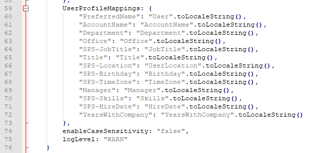

View Hidden Identity Values for Tracked User Operations with Hidden Identities
See the User Profile mappings from the DefaultModuleSettings.js file below.
  • The file format is set as:
       "User Profile Property Name": "Analytics internal mapping name"
  • The property name from the User Profile appears on the left side of the colon ':' on each line.
  • The Analytics internal mapping name appears on the right side, after the colon ':' on each line.
Hidden User Identities
For each User Profile property (such as Department, Job, or Location): if a user chooses to track operations, but to hide their identity, a unique value appears, such as Anonymousasda43dsad5.

By default all the queries are recorded and shown "lower case".
This causes the queries "test" and "Test" to be grouped and reported as "test".
If you need to enable case sensitivity for queries, copy the parameter enableCaseSensitivity (from DefaultModuleSettings.js) into your pages's custom setting file and set it to true.
