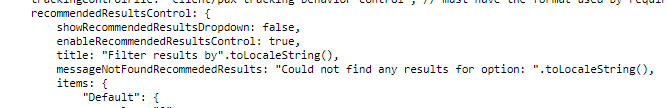

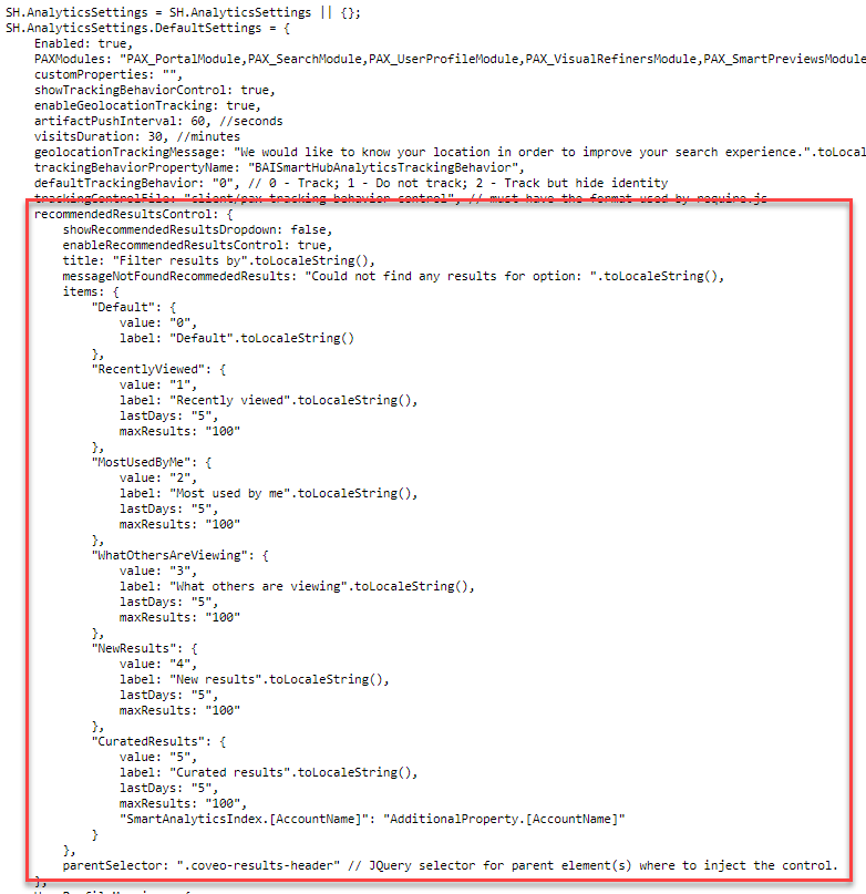

- Search for the word "recommendedResultsControl" on the page to quickly navigate to the Recommended Results default settings, nested under the AnalyticsSettings component shown below:
- Copy the entire recommendedResultsControl section.
- Go back to your Advanced settings edit tab.
- Paste the copied settings inside section SH.AnalyticsSettings.CustomSettings.
Set the showRecommendedResultsDropdown setting to true and change the parentSelector setting to use a JQuery selector for the parent element where you are injecting the control.

SH.AnalyticsSettings = SH.AnalyticsSettings || {};
SH.AnalyticsSettings.DefaultSettings = {
Enabled: true,
PAXModules: "PAX_PortalModule,PAX_SearchModule,PAX_UserProfileModule,PAX_VisualRefinersModule,PAX_SmartPreviewsModule,PAX_Ratings,PAX_ChatBotModule,PAX_SmartAutomationsModule",
customProperties: "",
showTrackingBehaviorControl: true,
enableGeolocationTracking: true,
artifactPushInterval: 60, //seconds
visitsDuration: 30, //minutes
geolocationTrackingMessage: "We would like to know your location in order to improve your search experience.".toLocaleString(),
trackingBehaviorPropertyName: "BAISmartHubAnalyticsTrackingBehavior",
defaultTrackingBehavior: "0", // 0 - Track; 1 - Do not track; 2 - Track but hide identity
trackingControlFile: "client/pax-tracking-behavior-control", // must have the format used by require.js
recommendedResultsControl: {
showRecommendedResultsDropdown: false,
enableRecommendedResultsControl: true,
title: "Filter results by".toLocaleString(),
messageNotFoundRecommededResults: "Could not find any results for option: ".toLocaleString(),
items: {
"Default": {
value: "0",
label: "Default".toLocaleString()
"RecentlyViewed": {
value: "1",
label: "Recently viewed".toLocaleString(),
lastDays: "5",
maxResults: "100"
"MostUsedByMe": {
value: "2",
label: "Most used by me".toLocaleString(),
lastDays: "5",
maxResults: "100"
"WhatOthersAreViewing": {
value: "3",
label: "What others are viewing".toLocaleString(),
lastDays: "5",
maxResults: "100"
"NewResults": {
value: "4",
label: "New results".toLocaleString(),
lastDays: "5",
maxResults: "100"
"CuratedResults": {
value: "5",
label: "Curated results".toLocaleString(),
lastDays: "5",
maxResults: "100",
"SmartAnalyticsIndex.[AccountName]": "AdditionalProperty.[AccountName]"
parentSelector: ".sh-main-results-container" // JQuery selector for parent element(s) where to inject the control.
UserProfileMappings: {
"PreferredName": "User".toLocaleString(),
"AccountName": "AccountName".toLocaleString(),
"Department": "Department".toLocaleString(),
"Office": "Office".toLocaleString(),
"SPS-JobTitle": "JobTitle".toLocaleString(),
"Title": "Title".toLocaleString(),
"SPS-Location": "UserLocation".toLocaleString(),
"SPS-Birthday": "Birthday".toLocaleString(),
"SPS-TimeZone": "TimeZone".toLocaleString(),
"Manager": "Manager".toLocaleString(),
"SPS-Skills": "Skills".toLocaleString(),
"SPS-HireDate": "HireDate".toLocaleString(),
"YearsWithCompany": "YearsWithCompany".toLocaleString()
enableCaseSensitivity: "false",
logLevel: "WARN"
