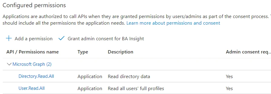

How to Specify the Required Permissions in Azure
Procedure:
  1. Log in to your Azure portal as an administrator: http://portal.azure.com.
  2. Go to Azure Active Directory > App registrations.
  3. If you previously registered an app to talk to SharePoint Online, find that app.
    1. If there is no such app, click New registration to register the new app.
  4. Enter the App information:
    • Name: Enter the SmartHub user profile provider app.
    • Supported account types: Determines who can use the application or use the API.
    • Redirect URI: Enter your SmartHub URL such as https://search.company.com.
  5. Click Your app > API permissions > Add a permission > Select an API/Microsoft APIs > Microsoft Graph.
  6. Select the following Application permissions (your user interface may vary):
    1. User.Read.All: Read all users' full profiles
  7. Click Add permissions.
  8. You return to the App > API permissions page. Unless you are a tenant administrator, you will see a caution message at the top of the page stating that Administrator consent must be given before some or all API permissions are activated.
    1. API permissions without granted consent state this under the STATUS heading in the table in the center of the page.
  9. Click the Grant Admin consent for[Organization Name] button under the Grant consent heading on the same page.
