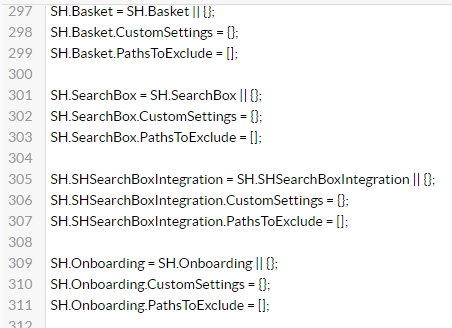

Scroll down and search for the text "
SH.SearchBox.CustomSettings"
Click the See Default Settings link at the top right.
A new browser tab opens with all available SmartHub module settings.
SH.SearchBox.DefaultSettings = {"
Copy the settings under settings after the text "SH.SearchBox.DefaultSettings = {".
Go back to your Advanced settings edit tab.
Paste the copied settings inside the section "SH.SearchBox.CustomSettings = {".
Modify the settings as desired. See the table SearchBox Settings below for more information.

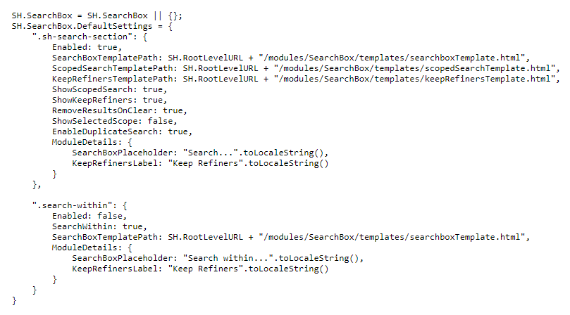

Example Configuration
SH.SearchBox = SH.SearchBox || {};
".sh-search-section": {
Enabled: true,
SearchBoxTemplatePath: SH.RootLevelURL + "/modules/SearchBox/templates/searchboxTemplate.html",
ScopedSearchTemplatePath: SH.RootLevelURL + "/modules/SearchBox/templates/scopedSearchTemplate.html",
KeepRefinersTemplatePath: SH.RootLevelURL + "/modules/SearchBox/templates/keepRefinersTemplate.html",
ShowScopedSearch: true,
ShowKeepRefiners: true,
RemoveResultsOnClear: true,
ShowSelectedScope: false,
EnableDuplicateSearch: true,
ModuleDetails: {
SearchBoxPlaceholder: "Search...".toLocaleString(),
KeepRefinersLabel: "Keep Refiners".toLocaleString()
".search-within": {
Enabled: false,
SearchWithin: true,
ModuleDetails: {
SearchBoxPlaceholder: "Search within...".toLocaleString(),
