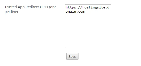

Configure Security in SmartHub Admin
  1. Navigate to the SmartHub Administration page.
  2. Go to the Security Settings section.
  3. Add your Akumina site URL to the Trusted App Redirect URLs field.
  4. Click Save.

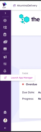

    1. Navigate to the Akumina App Manager by using the toolbar from your site.

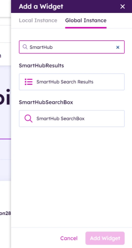

  1. Navigate to the desired Akumina page.
  2. Enter edit mode and add the widget you want to use.

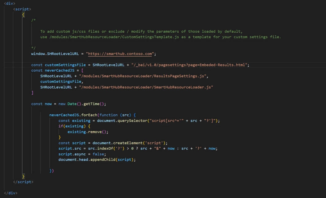

  4. Go to Advanced HTML Edit and make the following changes:
    1. Remove all the non-script tags from the head and everything above the <head> tag.
    2. Replace the <head></head> and <body></body> tags with <div> and </div> while keeping the inner contents of those tags:
    3. For the DIV with ID "search" add a new attribute data-main="true"
    4. Replace the src attribute of logo with the absolute URL.
    5. Change the SHRootLevelURL value to your SmartHub root address.
    6. Make sure that customSettingFile is pointing to "Embeded-Results.html"
    7. const customSettingsFile = SHRootLevelURL + "/_bai/v1.0/pagesettings?page=Embeded-Results.html";

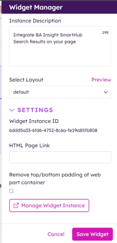

  1. Go to the Akumina Page where you have added the widget
  2. Go to Edit Mode
  3. Select and edit the SmartHubResults widget
  4. Add the Embedded-Results.html complete URL on the HTML page link setting.
  5. Save the widget

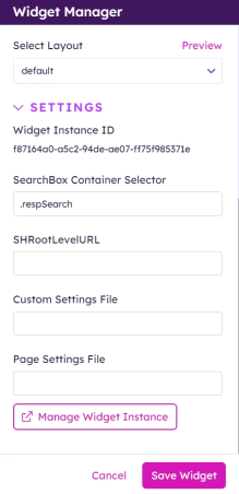

  1. Go to the Akumina page where you have added the widget.
  2. Go to Edit Mode.
  3. Select and edit the SmartHub SearchBox widget.
  4. Set the selector for the container where the SmartHub SearchBox will render.
  6. Add the full URL for the TypeAhead custom settings modified earlier.
  7. Add the full URL for the TypeAhead page settings modified earlier.
  8. Save the widget.
Info: The out-of-the-box the value for the SmartHub SearchBox is ".respSearch" meaning it replaces the Akumina SearchBox.
If the container doesn't exist it can be added by modifying the Akumina Master page via the View Manager or the value changed to one that exists in the page.
The Akumina SearchBox can also be manually removed by editing the Master Page via the View Manager.
